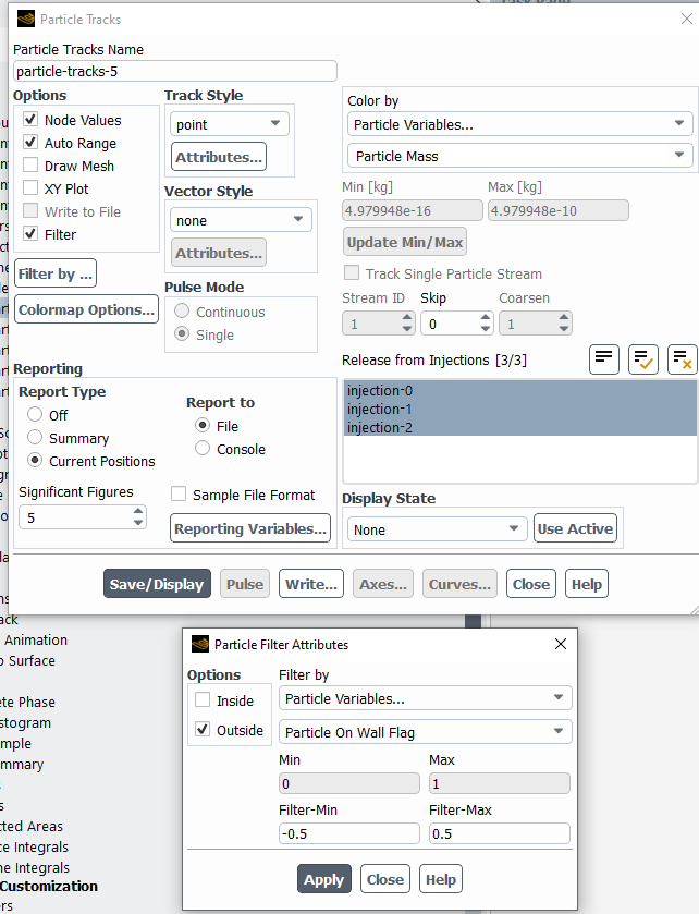

SubscriberFor example, if I want to get the total mass of injected DPM spray droplet particles which are ended up suspended in the fluid domain, to compare the total mass of accumulated DPM wall particles that form the liquid film. Although I checked section 20.8. Postprocessing for the Discrete Phase of the Fluent user guide, I did not find a similar function of doing this...

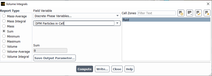

Also the DPM report function, there is no option to do the sum for only the particles without on-wall flags. And there is no wall film... option for the field variable.

Ansys EmployeeSo verified in the manual (assuming all users will do the same). You can create built-in DPM Report Definitions for DPM Film Mass and Any DPM Particle suspended in the domain: I guess that is actually what you want to achieve.

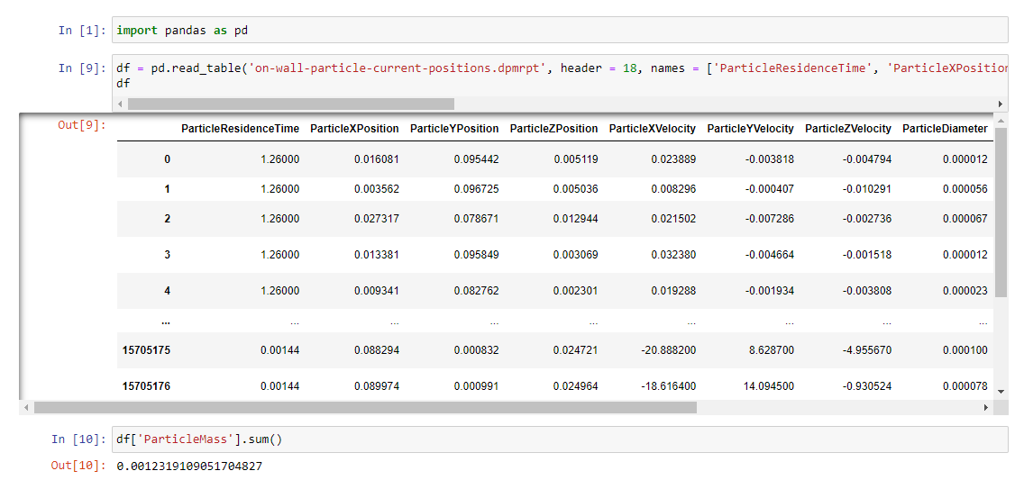

But I also encountered a strange problem as described below.
I used the following settings to get the statistics information of all on wall particles, then I used a Python script with Pandas to sum the particle mass, which gives me the result 0.001231 kg, which is different from the value given by the DPM extended summary, 0.00625kg, why is that?
