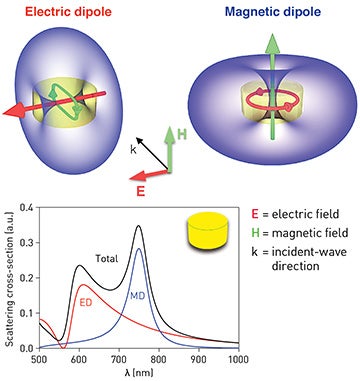

      can you please suggest how to do the decomposition of the Electric dipole (ED) and magnetic dipole (MD) effect from the spectra? Is it possible through Lumerical?
      As it is done here.

      This may need multipole decomposition. Please refer:
      https://optics.ansys.com/hc/en-us/articles/1500007399722-About-monopole-dipole-quadrupole-hexapole-octupole-etc
      You may also need to get more information from the paper and its references.

      Do you know how to calculate the relative phase between the dipoles or higher order poles?
    • Guilin Sun
      You have to expand the fields into different poles.

      Guilin Sun, can you do the multipole decomposition of Si nano sphere through Lumerical as an example and also the phase calculation.
    • Guilin Sun
      Unfortuately I cannot as Lumerical does not have such a function. You can search online for multi-pole decomposition. You may find a free software if you are lucky.
