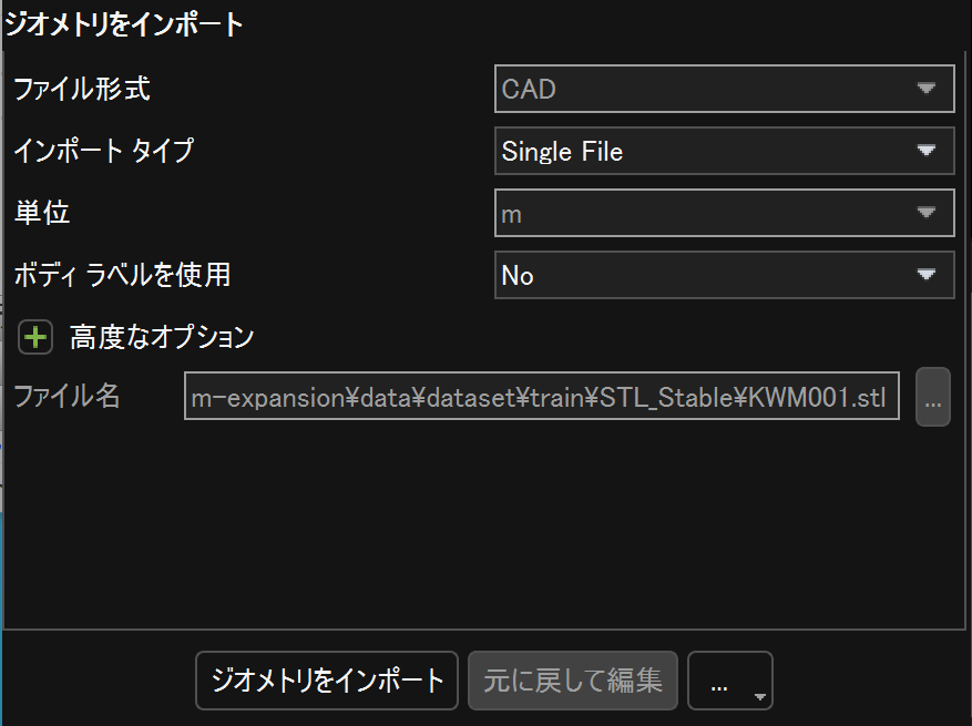

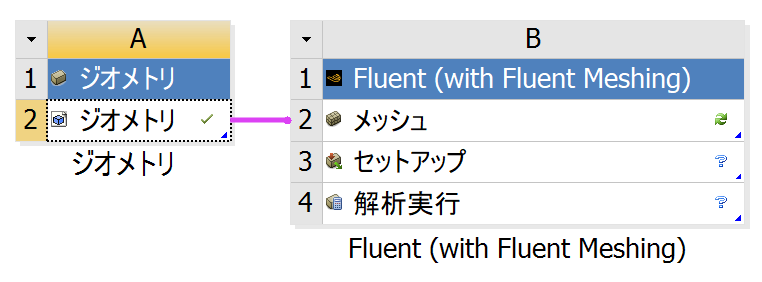

      I first imported the STL file into the geometry.
      We transferred the data to Fluent (with Fluent Meshing).
      I then tried to edit the mesh.
      However, in the mesh module, geometry could not be imported.
      I would like to know the reason for this and the solution.

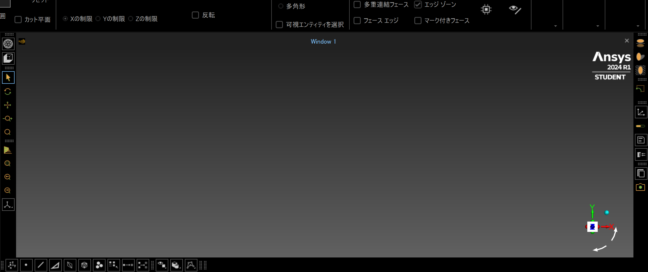

    • Kanta Shimizu
      No, I don't get an error message.
      Nothing happens when I press the ”ジオメトリをインポート" (import geometry) button.
      Window1 shows nothing.

    • Kanta Shimizu
      Meshing> Reading "C:Path\dp0\FFF-1\Fluent\FFF.msh.h5" ...
      3D mesh
      nodes: 0
      edges: 0
      faces: 0
      cells: 0
      reading 0 node zones
      reading 0 edge zones
      reading 0 face zones
      Warning: no nodes readanalyzing boundary connectivity...done.
