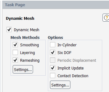

July 4, 2021 at 9:07 pmJuly 5, 2021 at 1:10 amYasserSelima
Subscriber"Define adjust" and "define profile" are two different functions. Go to the manual and look for examples on define-adjust
July 6, 2021 at 9:48 amJuly 6, 2021 at 10:25 amRob
Forum Moderator6DOF tends to be used for free moving objects, which generally don't deform. They also don't hit anything. You want to model a valve closing so need to fix the motion and figure out when to stop the motion so the valve doesn't fully close. As it's a reed valve (so the valve deflects, or at least in the type I've seen they do) you can't just assume a motion.
