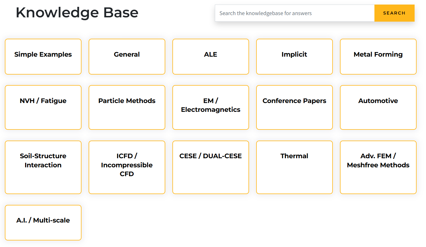

      Just some brief info - Often one can perhaps just fully fix the base completely and apply acc. load (shock)
      See this in the Knowledge Base  section in ACSS which you have access to (How can we apply multiple shock loads, ensuring that the vibrations are reset to zero after each shock before applying the next one in Workench LS-DYNA? ) Also ozeninc + shock + pdf doc. if you search for that.
