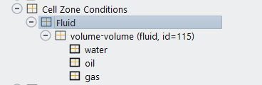

December 8, 2022 at 2:34 pm
December 8, 2022 at 2:45 pm
Rob
Forum ModeratorDid you label the cell (volume) zones or the faces? NS are generally passed over, but it's common for people to only label faces.Â
December 8, 2022 at 2:48 pm
javat33489
SubscriberLooks like I made a surface when I did it in SPACECLAIM. How to make a volume so that I can watch its volume?
December 8, 2022 at 3:05 pm
Rob
Forum ModeratorSplit the volume and label in SpaceClaim. In Fluent you can split cell zones using Registers: not as straightforward but worth learning. It'll be covered on here somewhere.Â
