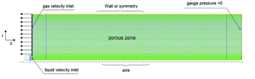

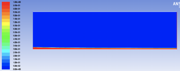

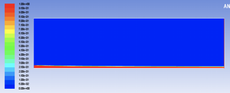

      Hello Karthik,nThank you. I am simulating the counter-current gas-liquid flow in a tube using the 2D axisymmetric model. The gas velocity and liquid velocity are -1 and 1m/s, respectively. nnI thought that there is no fluid-fluid interfacial force when using the VOF method, so the results of case 1 and case 2 should be the same. However, case 2 cannot converge, and the results of case1 and case3 are similar. The pictures show the liquid fraction of case1 and case 3. So I wonder maybe there is a fluid-fluid interfacial force in the VOF method. Many thanks.nn
