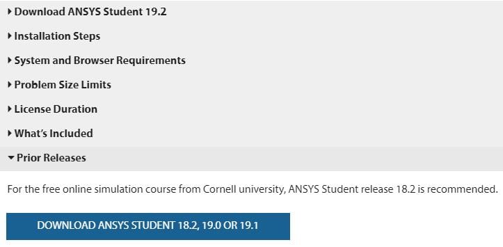

I recommend you uninstall ANSYS Student 19.2 and download ANSYS Student 19.1 on your laptop. That way you won't have any problems moving models between the school computer and laptop. Click on Download, then in the list is Prior Releases where you can find 19.1. Discard any models saved in 19.2

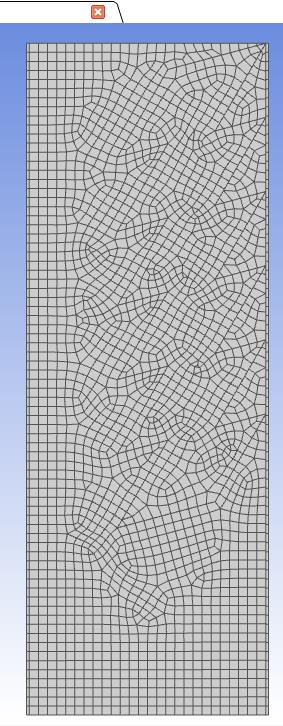

December 1, 2018 at 9:11 am
moda9742
SubscriberDear Peter,
Like always, please accept my sincere appreciation. Actually, I tried to follow your instructions (to combine the similar wedges and insulators). However, it did not work for me.Â
BTW, I just meshed my geometry (maybe not very accurate, but acceptable enough)! My results are enclosed in the attached file. I was wondering if you could do me a favor and take a look!
Finally, I need to calculate heat flux through each (front &rear) glass plates. My final values should be around 23 & 56 (w/m2). Can you please show me how to get such values from the results?
I really appreciate all your support.
Sincerely,
December 1, 2018 at 2:07 pm
peteroznewman
SubscriberDear Moda,
This post is just to show you the merged insulators.
I opened the file attached above and opened SpaceClaim.Â
- File, Save As and set the type to ACIS
- File Open, type ACIS, set the Options to Uncheck create Components from ACIS bodies
- Hide all components except for the insulators
- Click the Combine tool and click the top insulator
- Click the Add button and box-select all the other insulators, it's done.
Attached is the SpaceClaim 19.1 document.
I will look at the heat flux question later today.
Peter

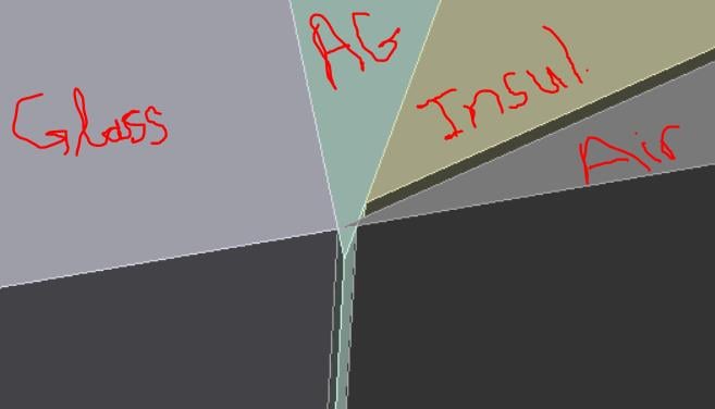

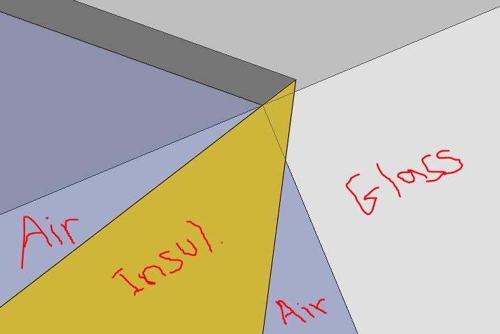

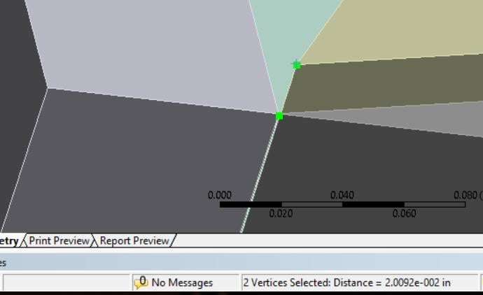

 P.S. I later found an error in the length of the insulators, they extend past the glass and air. You should fix that.
After I fixed the above error, there are remaining geometry errors that cause meshing problems.
The AG extends too far and the Insulator doesn't touch the Air.
Please fix these errors and attach a new Archive.

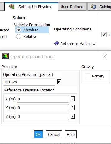

In my previous post, I showed changing Air to an Ideal Gas. The reason is you want the density to be a function of temperature so that gravity will create natural convection by pulling down the heavier, colder air, while the lighter hotter air rises.Â
In your Fluent model, the Air has a constant density. I will change that to Ideal Gas using the pull down on the Density line that currently says constant.
Another difference which may or may not be important. I changed to the Density-Based Solver, while your model had the Pressure-Based solver. I don't know which one is better.

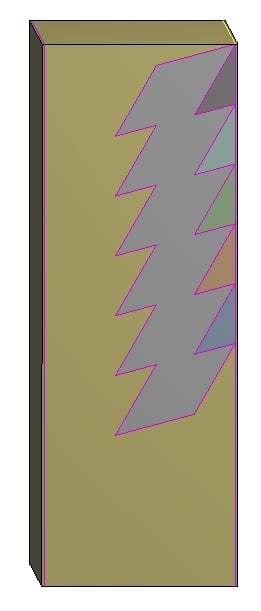

I will look at your model today. I just opened the Geometry, and see you haven't used Shared Topology, probably because the geometry is not yet perfect.
When the geometry is perfect, Shared Topology will allow all the bodies to be meshed and no contacts will be needed between the bodies.

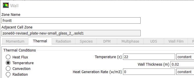

On the frontt Wall BC, where you apply a Temperature, did you type in the Wall Thickness value of 0.02 m or was that automatically populated?
If you typed that in, why do you think that is correct? What does the ANSYS Help say about that? The reason I ask is that you are modeling the glass as a solid, so the thickness is already represented in the meshed geometry.

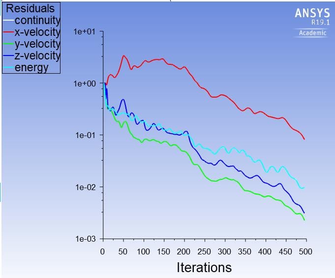

How many iterations did you run? The file only shows 100 iterations, but after 500 iterations, the solution is not yet near to meeting the convergence criteria of < 1e-3.

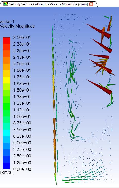

I ran the model until it converged with all residuals < 1e-3. I had two changes: Double Precision and Zero Operating Density.
I created a plane at X=40mm to plot velocity. There is a 20 cm/s downward draft on the back glass. The mesh is way too coarse for the AirGap wedges.

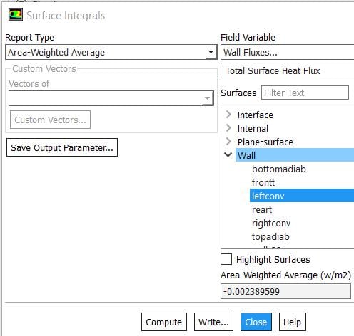

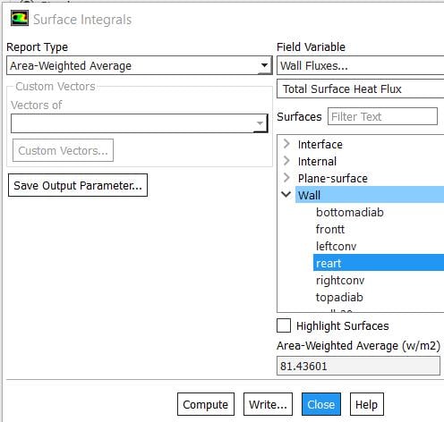

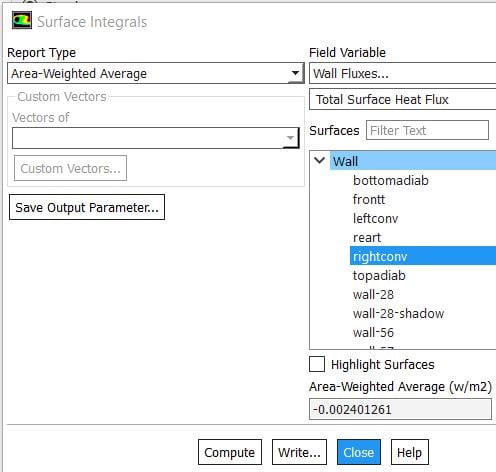

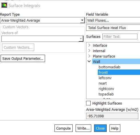

Heat Flux
In Fluent, in Post Processing, Surface Integrals...
Here is the frontt BC Area-Weighted Average Heat Flux
Here is the reart BC
Here is the leftconv
Here is the rightconv
There is zero heat flux on the top and bottom adiabatic surfaces.
For a Steady-State Thermal solution, I was expecting the sum of all faces to be zero heat flux, but the sum is not even close to zero. I wonder if it will get closer to zero with a finer mesh and a smaller convergence criterion on the Energy residual, like 1e-6.
Peter -

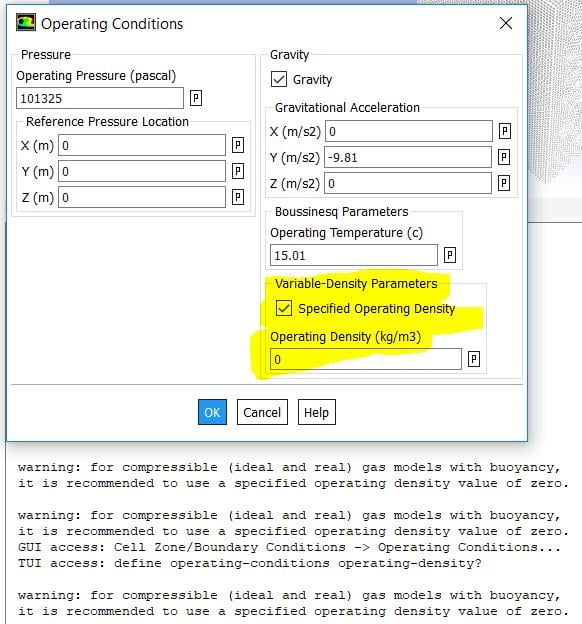

As far as density, are you sure I should pick bussinesq for air density (attached)?Â
I didn't say to pick bussinesq. rwoolhou suggested incompressible ideal gas, but that was without a complete understanding of the problem. It's a fixed volume, so I suggested ideal gas.

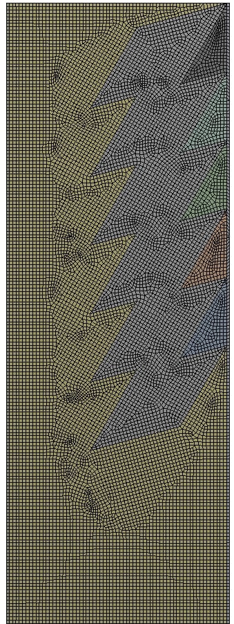

December 3, 2018 at 3:06 am
peteroznewman
Attached is the perfected geometry version of your model. You can tell the shared geometry is working when you get the purple and yellow colors for common edges. Show your SolidWorks friend that it is possible to have perfect geometry. Zoom into that top right corner as much as you like. They all meet at a point.
I managed to mesh it with smaller elements and kept the mesh below the Student license limit of 512 K nodes/cells.
Because Shared Topology is working, there is No Contact, so the list of Walls is a lot shorter in Fluent now.
Enjoy!

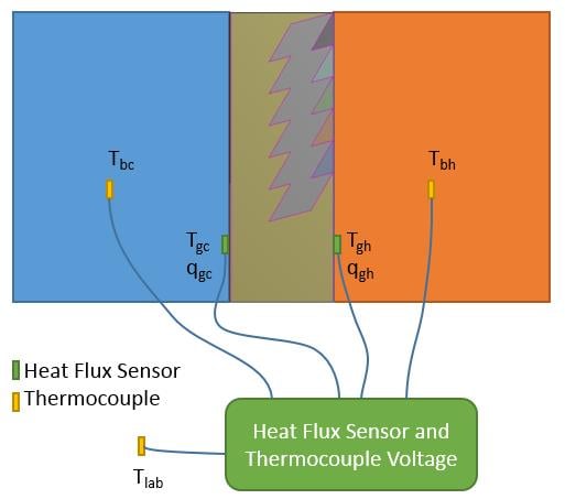

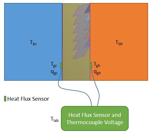

Thanks for the manual on the instrumentation; I learned something new! The sensor you called a thermocouple is actually a heat flux sensor with an integral thermocouple. I didn't know about that before, now I understand how you get heat flux, it is measured directly.
I made the following figure to represent your Thermal Wall. You have a cold side where the bulk temperature of the air is Tbc, you have a heat flux sensor on the glass measuring the glass temperature on the cold side of Tgc and the heat flux qgc. You have a hot side where the bulk temperature of the air is Tbh, you have a heat flux sensor on the glass measuring the glass temperature on the hot side of Tgh and the heat flux qgh.Â
Outside of the controlled temperature environments on either side of the wall is the lab space where the temperature is Tlab and that is where the voltages are being measured, probably on the FluxTeq DAQ. Is the correct?
My point on a previous post was that the temperature of the glass on the hot side could be very different near the top where there is a trapped wedge of air next to the glass than it is near the bottom where there is natural convection occurring in the wall cavity.
That is why a better BC for your Thermal Wall model would be Convection on both glass surfaces. I assume you have some idea of the bulk temperature of the air on each side. But the issue is what is an accurate estimate of the convective heat transfer coefficient, h, for use in the CFD model convective BC?
Get two or three more thermocouples and plug them into the DAQ to measure the bulk temperatures directly. Also, it is more accurate to have a thermocouple measuring the temperature in the lab. Here is the updated figure.
Given that you have an actual heat flux sensor, you can calculate the convective heat transfer coefficient from the equation
h = q/(Tg - Tb)
which is the definition of that quantity.
Do this for the hot and the cold side of the wall and use each value of h in your convective BC along with the measured bulk temperature.
Finally, looking at the photograph of the Thermal Wall, I see a wooden frame on the sides and top and bottom of your Thermal Wall, so I would make those four sides Adiabatic.
There is a lot more detail in the heat flux sensor manual you provided above. Are you implementing the temperature correction for the heat flux? I assume you read the bit about the voltage output from the thermocouple gives you the temperature difference between Tg and Tlab so that if you want the absolute value of the temperature of the glass, Tg, you have to add Tlab to the reading from the thermocouple. How are you measuring Tlab? You could do that with an extra thermocouple.

BTW, would you please let me know how to "Â run the model twice, once at sea level and then rerun it at Boulder, CO elevation". I don't know where could I define my current location/elevation.
Sincerely,
December 5, 2018 at 3:58 am
peteroznewman
SubscriberI mean set the operating pressure for sea level and then set the operating pressure for whatever it is in Boulder.
December 5, 2018 at 4:12 am
moda9742
SubscriberThanks. I see. However, I do not know how to change that operating pressure!
Sincerely,

Sorry, I don't work for ANSYS so I don't have any licenses to hand out. Ask your school if there is a way to take home the full license, maybe on a school laptop.
I suggest you find out how to get Windows Remote Desktop access to the computer at school that has ANSYS installed. That way, you can run your model on the school computer from home.
Kind regards,
