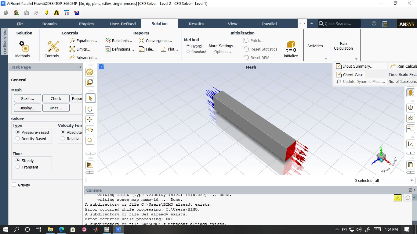

September 14, 2021 at 7:03 am
bimodwilaksono
SubscriberSeptember 15, 2021 at 12:57 pmGeorge Karnos
Ansys Employee@bimolaksono25 The graphics are set by Windows OS.
1.Change the High DPI settings under compatibility settings." Properties of workbench/fluent > Compatibility > Click on Override high DPI scaling "
2. Change the "Scaling performed by" option to "System(Enhanced)"
