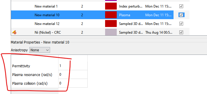

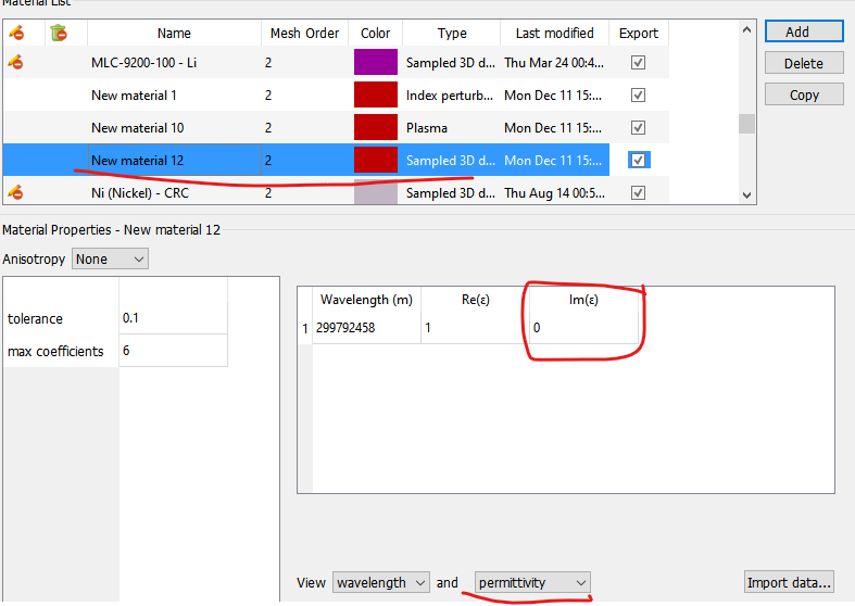

       It seems that there is not an option to input the imaginary part for the collision and plasma frequencies in the plasma material. However, I would suggest to add the real parts and use the plasma material model. On the other hand, you could use the real and imaginary part of permittivity/refractive index of a material (Sampled 3D). If you have the Refr indices of your material you could make a comparison between these two input materials and check if this is aligned with the reference you use. Please check both pictures below.

      Thank you for your support. I used refractive index constants and calculated resonance and collision frequencies by curve fitting using equation from . https://optics.ansys.com/hc/en-us/articles/360034394634-Standard-optical-permittivity-material-models-in-FDTD-and-MODE
       i considered only real parts of frequencies, the results for reflectance and transmittance are not similar with what i got from Sampled 3D.

      This link (Charge-distribution-to-change-in-refractive-index-theory) describes the models used to calculate perturbation in refractive index from charge density data. On the other hand, this link (Standard-optical-permittivity-material-models-in-FDTD-and-MODE) describes the mathematical models of the basic permittivity (or refractive index) to create a material and import it in the material database.
      The standard plasma-drude model has no imaginary part, thus means that the material you use is lossless. It is expected to not get the same results. However, I reckon that according to the reference you use the transmission/reflection results are close to the model with the imaginary part included. Is that correct?
      In the meanwhile I will check with my colleagues if there is a feature that will include the imaginary part of plasma and collision frequencies in the future.
