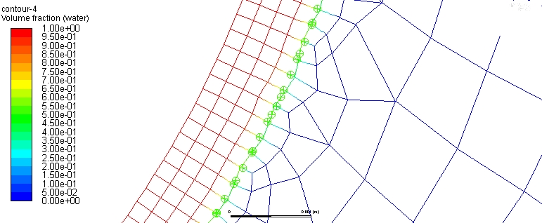

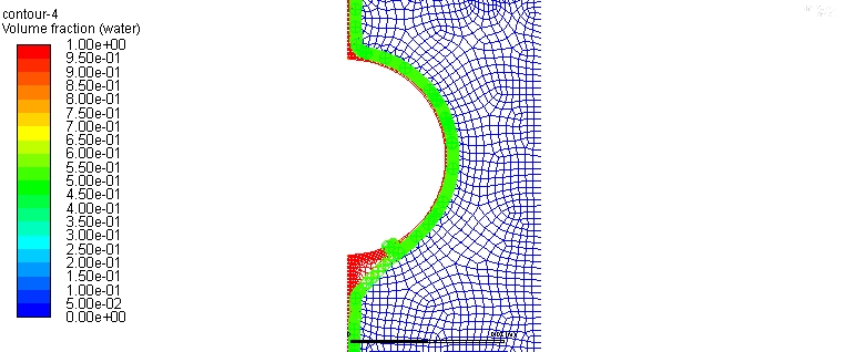

    • Prudviraj
      Dear sir, I have attached images after creating the isosurface volume fraction of water 0.5...please suggest me the next steps to find film thickness with respect to circumferential angles.......

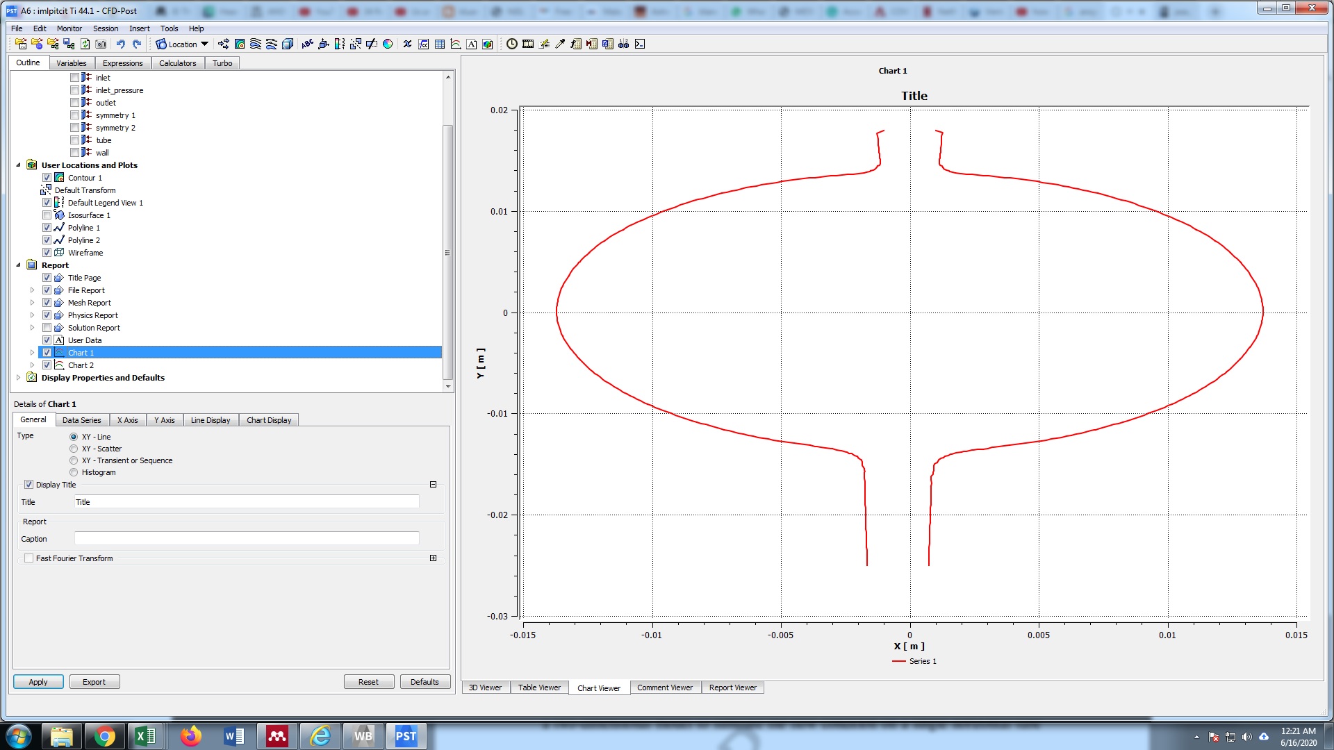

    • fit78
      Alternatively, you can generate a polyline from the water fraction contour. Choose the contour level you see fitting the fluid film.
      Once you generated the polyline, generate an XY plot. You will get something like this

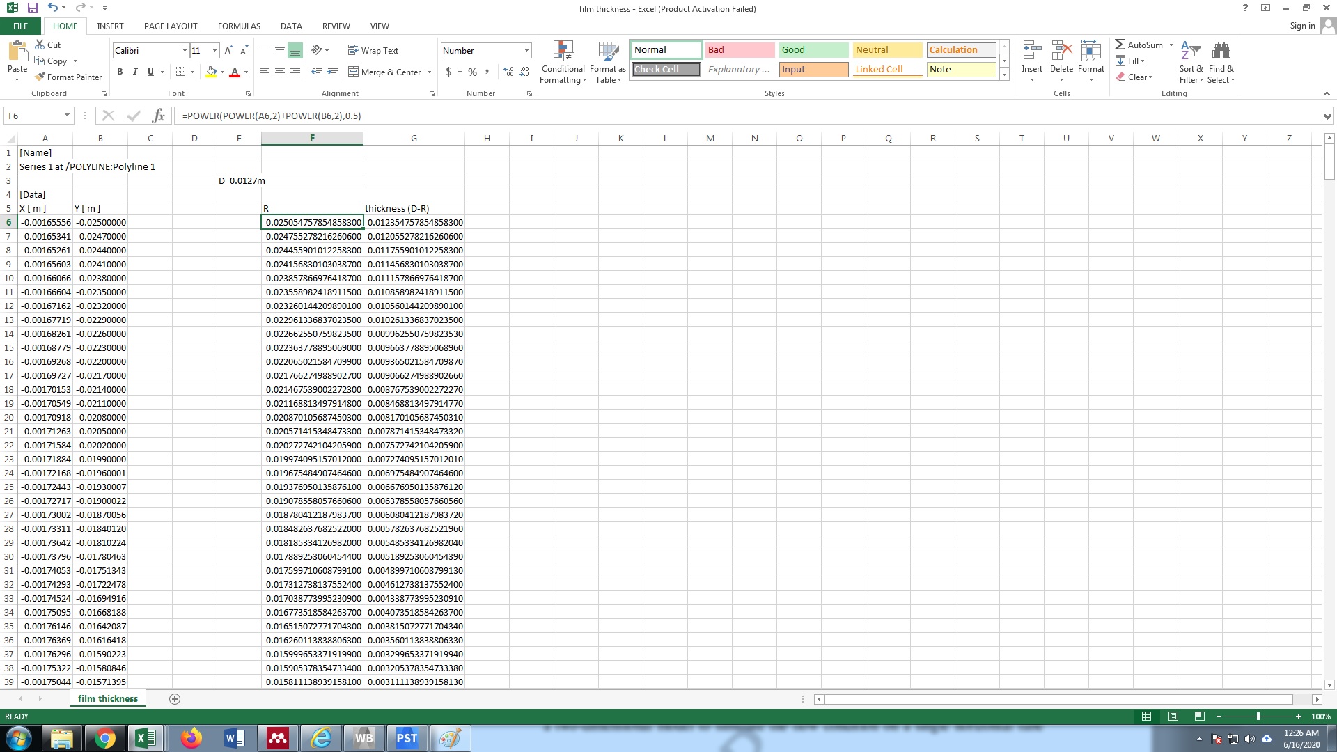

      Then you can export the XY plot and open it in a spreadsheet.
      By using X^2+Y^2=R^2, you can find the R which is the distance of the fluid film from the center axis.
      Easily, you may find the thickness by substracting the radius of the cylinder you were working on from the R value.
      To find the location of the film thickness, just use trigonometry since you already have the X and Y location.
