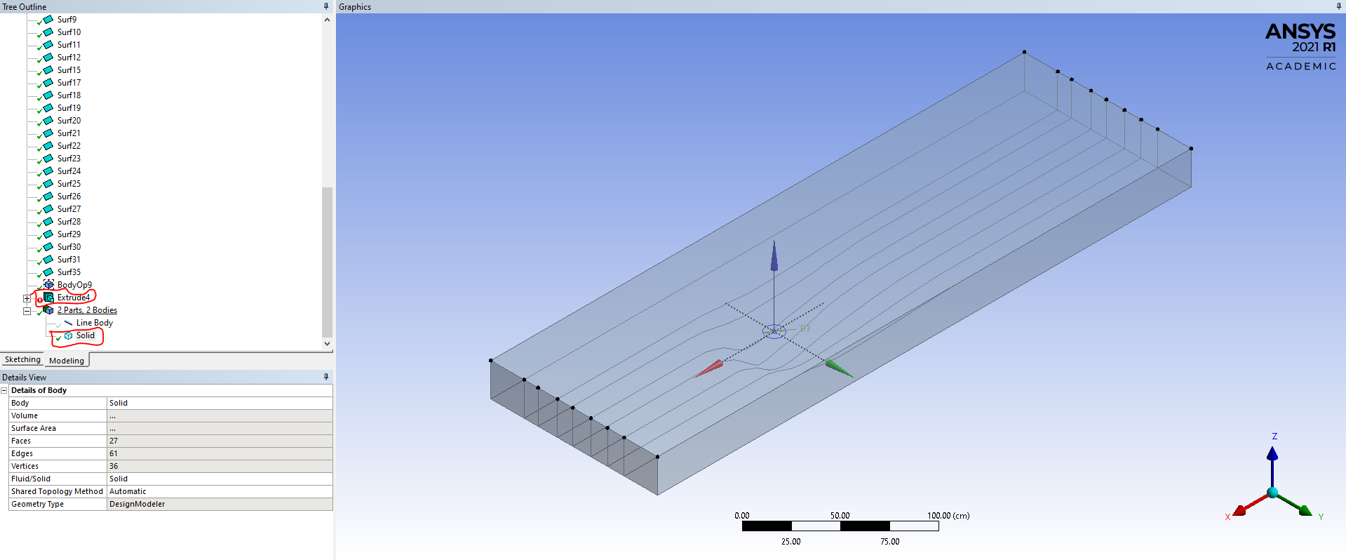

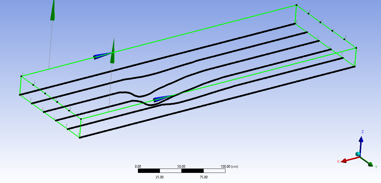

      I have a coordinates (X,Y, and Z) of all points as shown below. I have a lot of points in between the black lines displayed below. I imported only few points to avoid clumsiness.
    • Keyur Kanade
      Yes, you are on correct path. Once you create surfaces, please use Sew command.
      Regards Keyur
    • murali666
      Thank you for your response.
      I combined all the surfaces and generated a solid body using the sew command.

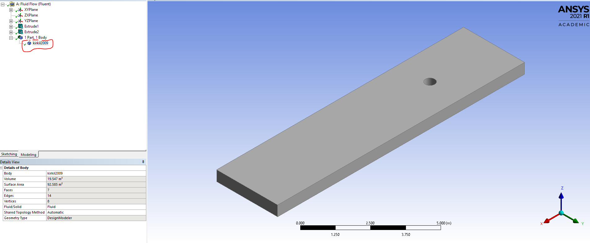

      But why this solid is looking like hallow, why it is not looking like actual solid body like below.
      I want to create a circular hole at center (as shown in circle in above figure) like as shown in the below figure. In below figure, first I created a circle on the bottom plane and extruded it and selected cut material option in during extrude operation. I tried to do the same in the above case, but it didn't worked.
      Please help in creating the circular hole in the above figure and explain me why both the solids are looking different.
    • Keyur Kanade
      To look like solid - change display option. Use view - shared exterior
      To cut hole - extrude as frozen option. Then use boolean operation to cut material.
      Regards Keyur
    • murali666
      Its worked, Thank you for your help.
