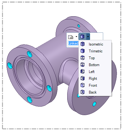

Ansys EmployeeHello JUGYEONG SHIN
You can create basic views using "Generic" option. The Generic option adds an isometric view by default. To change this view, click the arrow button next to isometric image and you will see a list of standard views. See below snapshot. You can select any view from this list to create that particular view in the drawing sheet.Â
The view added through "Generic" option is not linked to the geometry and you can rotate it as required.Â

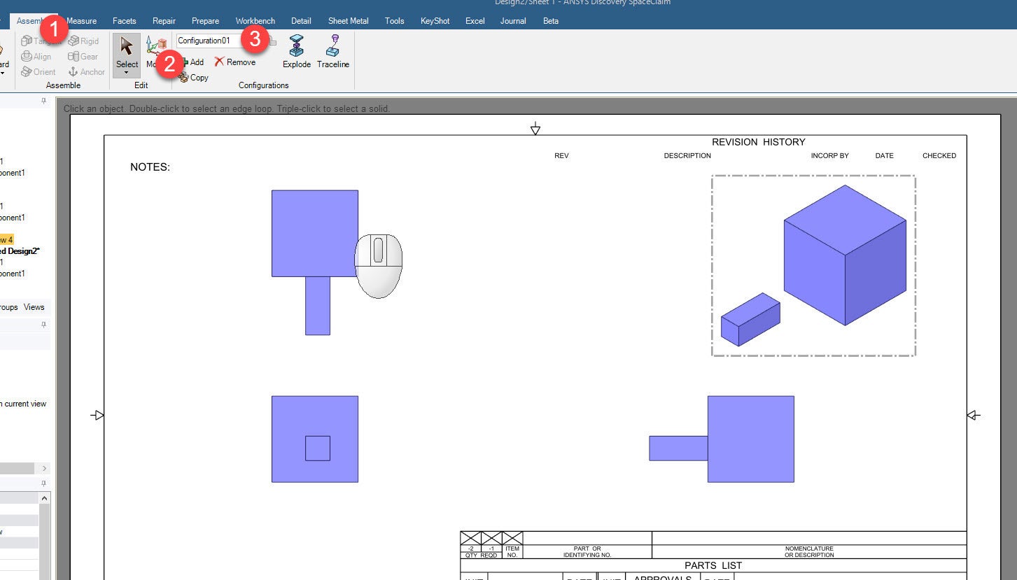

You can also save custom views in the views tab in the design space. They will appear in the view dropdown when you select a view.
Regarding moving a body in 1 view but not editing the model. In the assembly tab on the right are configurations. You can move components and add configurations while in the normal design space. Then in the drawing sheet, add a new general view, select the view and then select a configuration from the assembly tab and it will give you the view you exploded:
