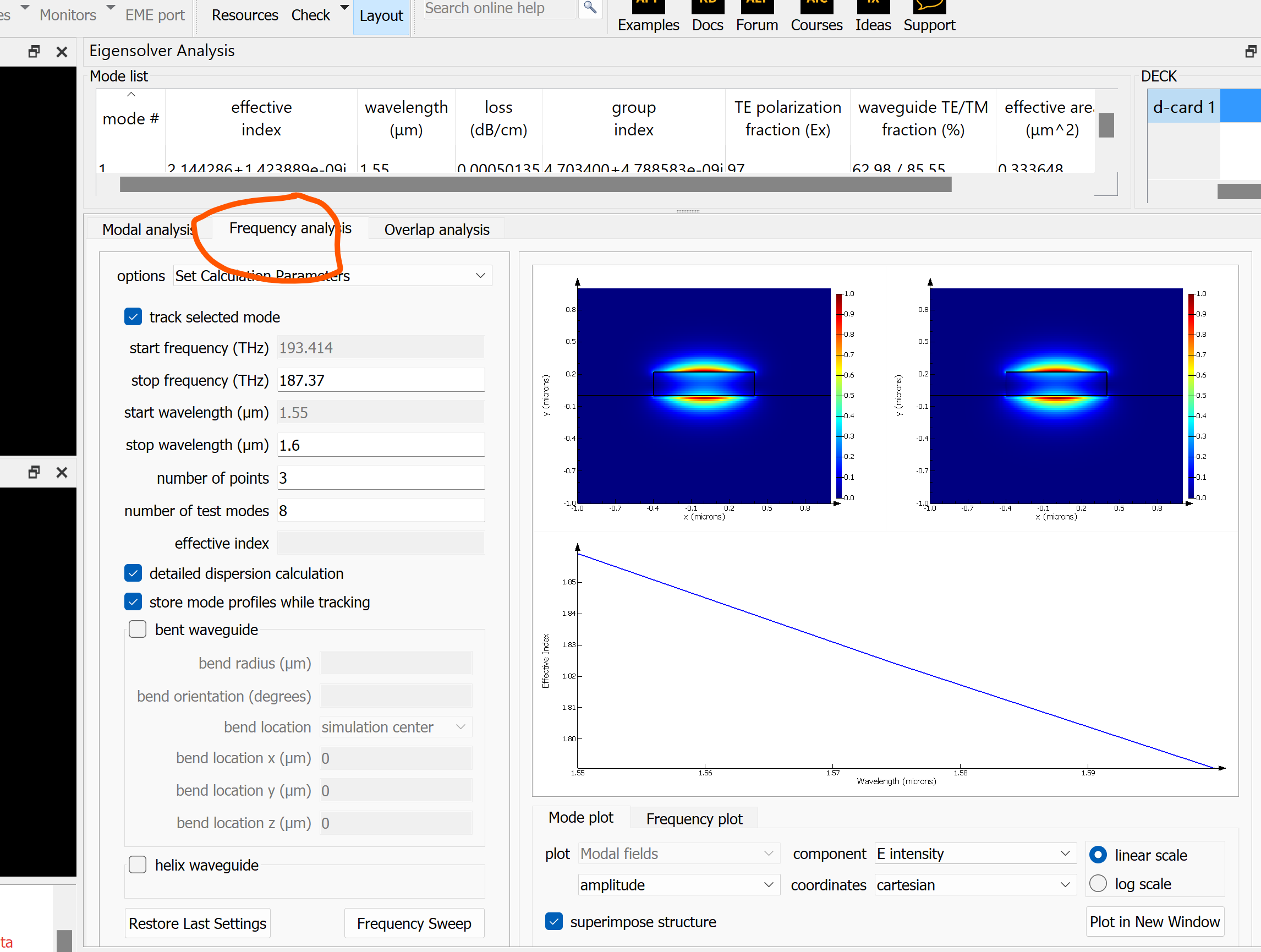

      Hi Guilin, thanks! is it possible to comment how the exact .ldf file was created in the given link (https://optics.ansys.com/hc/en-us/articles/360042833173). The .ldf file was already there in the downloaded example file. It would be good to know the source of it. Also, an .ldf file can have info about a whole simulation or only some field info. So, it is important to know the source of the given .ldf file to recreate the same results for me.
    • Guilin Sun
      It should be from the frequecy sweep in FDE, and then choose "export data" in ldf file.
      The file contains neff data at different frequencies for INTERCONNECT simulation.
      https://optics.ansys.com/hc/en-us/articles/360042800453-Waveguide-FDE-
