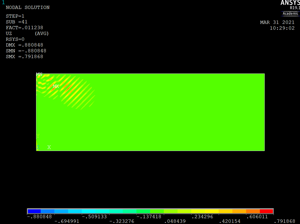

March 31, 2021 at 9:04 am
sdebode
SubscriberHi all,nI have a question regarding the elastic foundation. The page (https://simutechgroup.com/a-normal-and-tangential-elastic-foundation-in-ansys-workbench-mechanical/) its said that the elastic foundation acts as stiffness per unit area. However, when I apply the elastic foundation on an area, and refine the mesh, the stiffness seems to change. I am doing a case of a membrane in shear, so I am applying a in plane shear load to a flat membrane, and the elastic foundation stiffness acts normal on the surface of the membrane. I use Shell281 elements for the membrane mesh, and I use the exact code of the simutech page. See the illustration below.n
n I firstly perform a static analysis with the horizontal displacement based load, and then a buckling analysis to find the buckling modes as a consequence of this deformation. The following results show the same buckling mode for one mesh, and a mesh with a element size twice as small.nWhat is the cause of this difference? Is the elastic foundation really applying stiffness per unit area, or is it mesh dependent? Am I missing something.nnThanks in advance for your reply.nnBest regardsn
