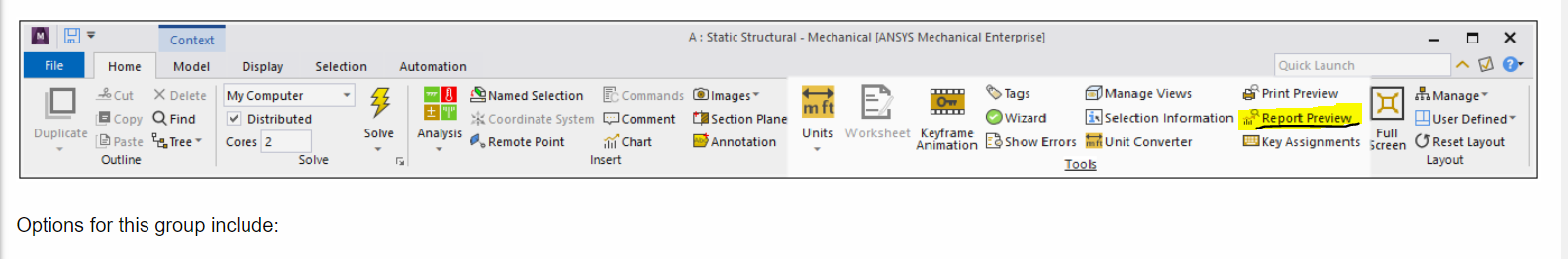

SubscriberI am using ANSYS 2021 R1. There was an option in Workbench to create a Report where I can see all the Stress Plots or Temperature Plots.
May I know how to create that Report in Workbench 2021 R1? Any help please? Thanks,
Awlad.
May 20, 2021 at 5:41 amErKo
Ansys EmployeeTry to push the button shown below - for more info on this search for 2021 R1 and report in help:
Report Preview (ansys.com)
