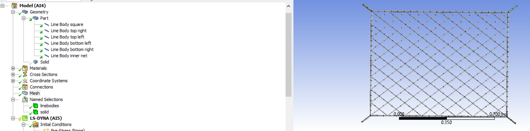

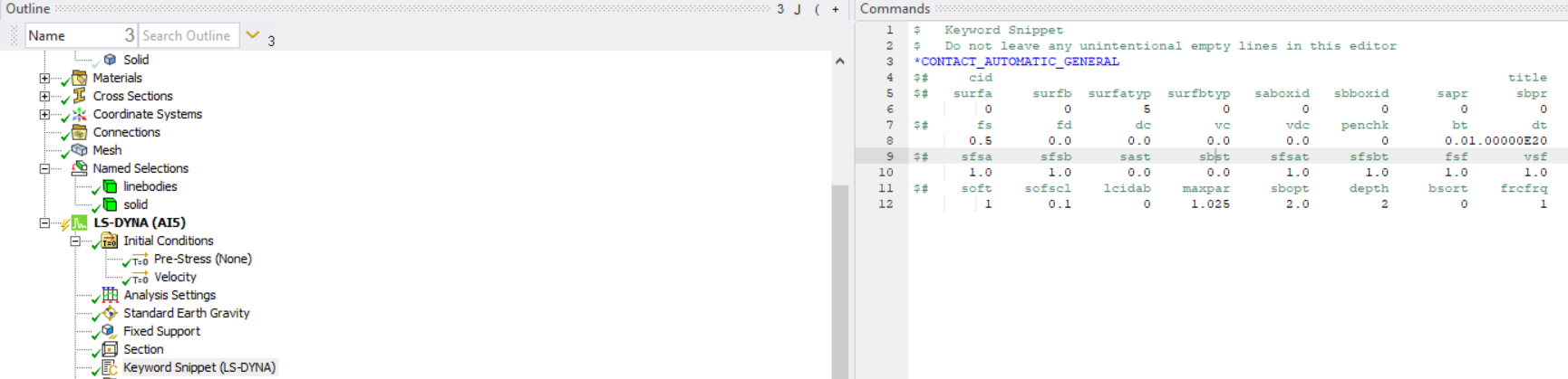

SubscriberHello, I'm working on a drop test simulation that features a net with different line bodies of varying cross sections. I'm using the following keywork script to govern the contact between the net and the falling weight, but I'm not sure how to make the line bodies connect to each other. I tried using joints, but that didn't work. Is there any easy way to connect the line bodies to each other? Thanks!

Ansys EmployeeHi ,Â
Assuming that you need an bonded contact, you can use share topologyÂ
cheers, ram
