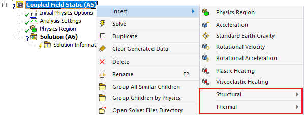

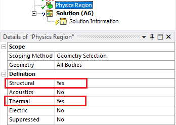

      To employ a 2-way coupled thermal-structural analysis, select a coupled field system from the list of Analysis Systems in the workbench:
      You will then be able to insert both thermal and structural loads and boundary conditions and the analysis will be fully coupled.
