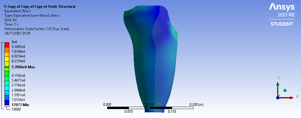

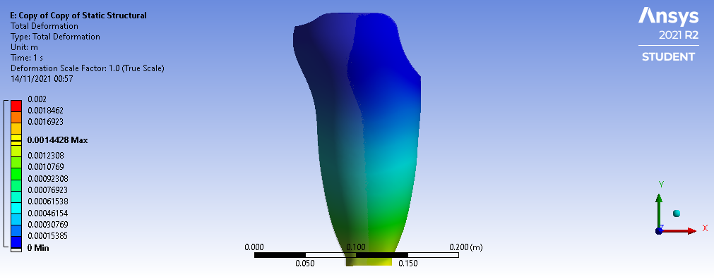

SubscriberI'm currently working on a project in which I want to simulate stress distribution at 3 different angles of load. I'm using Static Structural model for this. In all the models engineering data, geometry, mesh, fixed supports and magnitude of the force are same and only change is in the angle of the force vector.

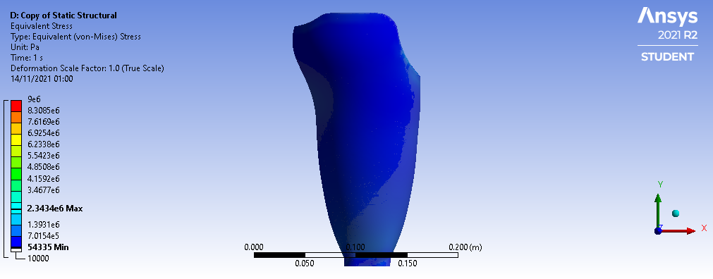

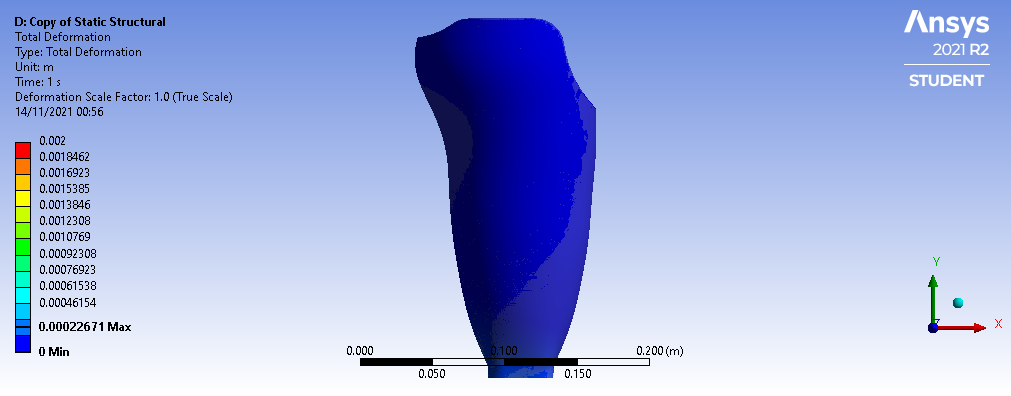

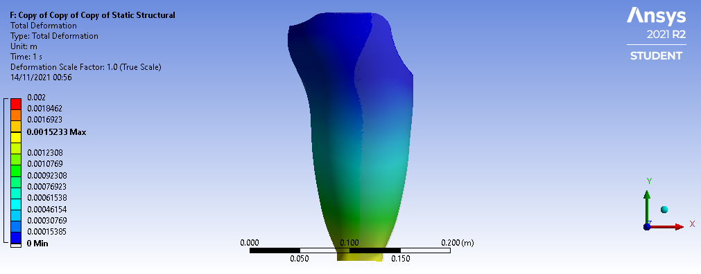

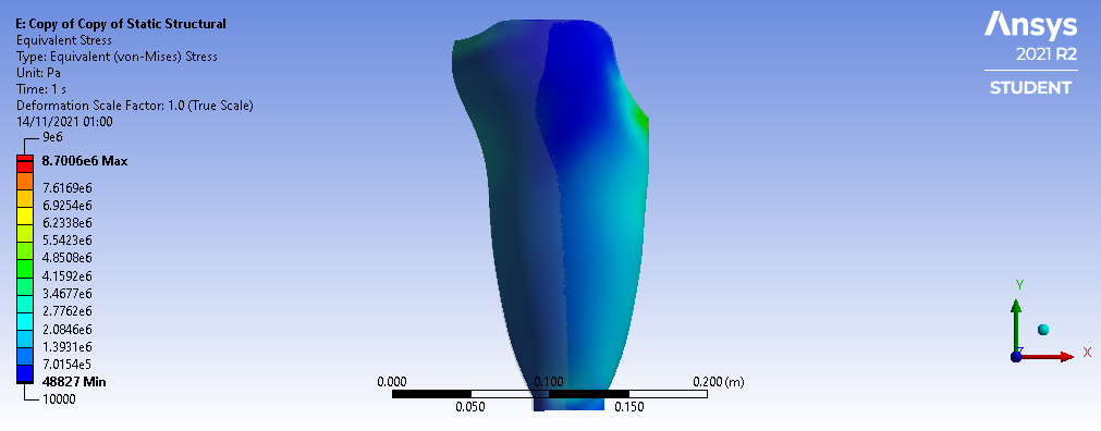

1) How can I compare results ( of contour plots) obtained from all these models ?Â
While comparing them, I want to keep the range of the contour plot same for all the results.

Subscriber1) Look at this discussion: /forum/discussion/18108/changing-scalar-range
and read this pdf file: https://www.padtinc.com/blog/wp-content/uploads/sites/2/2016/09/PADT_Mechanical_Custom_Legend_R17.pdf

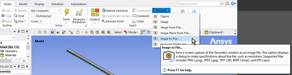

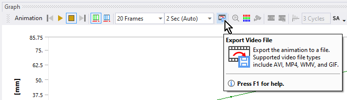

3) You can export videos from the Animation toolbar.
You can export images from Mechanical using the Images button on the Home Tab.

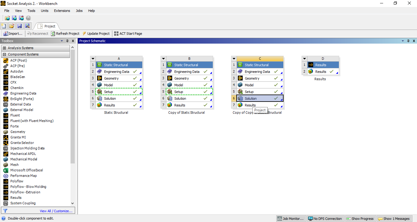

I followed as per step 1 and kept Range same for all the models. But still I am unable to use 'Results' to compare all the models.
I am trying to follow as shown in this video. https://youtu.be/clccZEmyO10
All the other solutions provided by you are good for one time use but not suitable for repeated work. In future complexity of the project, variables and design are going to change often. To compare in such scenario, use of 'Results' system as shown in above YouTube video at 7:38 .
Can you help me in finding out why I am unable to compare these models using 'Results' system as shown in the video ?
Thanks !
November 13, 2021 at 9:27 pmpeteroznewman
SubscriberThe video shows Workbench 17.2 and in that version, you could use the Results component for Mechanical and CFD Post Processing. In recent versions, ANSYS dropped the ability of Results to plot Mechanical results. It is only for CFD results now.
