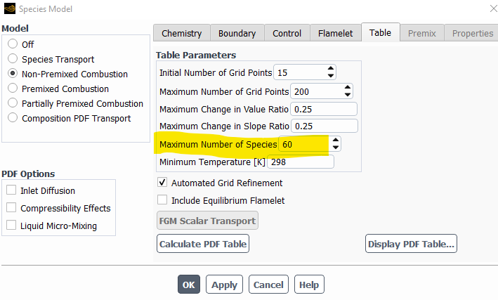

      To get minor species included in the PDF table, you can either increase the "Maximum Number of Species" in the "Table" tab of the "Species Model" dialog box (please see the screenshot below), or enter a small value for the mass/mole fraction of the desired species in the "Boundary" tab as you already suggested. You can also do both.
      Yes, you can plot species contour in CFD-Post just like other variables such as pressure.
