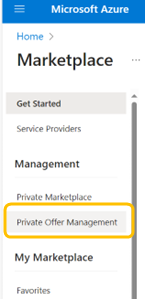

Go to the Marketplace:Â
Go to Private Offer Management in the left navigation panel:Â

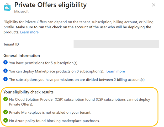

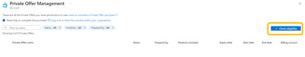

Click Check Eligibility on the right-hand side:Â Â
Check if CSP subscription exists. No Cloud Solution Provider (CSP) subscription found should be displayed. Â
