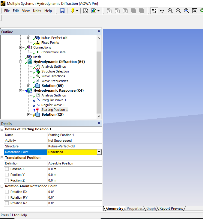

      Hello, I want to do a free decay test in the Ansys Aqwa Hydrodynamic Response program. I first want to determine the Initial Position of the structure with the desired conditions. But in "Reference Point", there is no option. is there a step i forgot? or how do I determine the Reference Point at the Starting Position in Ansys Aqwa?
      if you are willing, please give me a book/journal reference that explains the steps of the decay test on a floating structure. Thank You

      sorry about this, I've found the answer, you just need to specify the "connection point" in the menu tree for the object you want to give a starting position. in the starting position menu, this point will be the reference point selection
