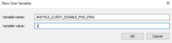

      In 5).5B.3.d of troubleshooting document,
      How to change the environmental settings?
    • Naresh Patre
      Tango Hiroyuki Go to Control Panel → System and Security → System → Advanced system settings → Environment variables. This will open Environment Variables panel. Under "User variables" section, click New and create a new user variable with variable name as ANSYSLS_CLIENT_DISABLE_FNO_PING and variable value as 1. See below snapshot. Follow the same process for creating other environment variable.
    • tango
      Naresh Patre
      Thanks a lot.
      I could set it.(but it didn't work)
