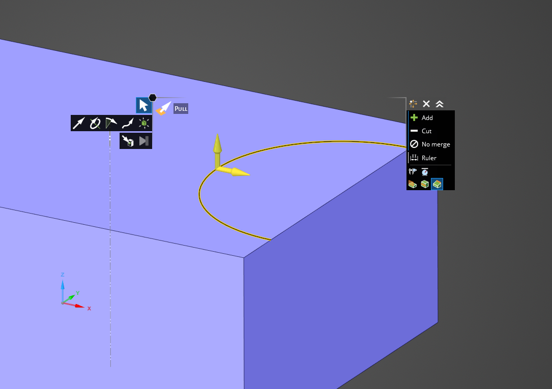

      An imprinted full circle can be manipulated with the pull/edge/pivot function. On a half circle this doesn't work. How do I change the radius from 8 mm to 5 mm in this case? The center point of the circle should remain at the same place.
      This operation is very useful when I want to modify fluid-solid interfaces in the refine mode.

      You can use ctrl while using the pull option to change the dimension while keeping the split there. Refer video attach.

      Thanks, but this one copies the edge. If I already have a boundary condition or contact on that particular face, I have to relocate that condition. At least it is a kind of workaround but not exactly what I was looking for. Is there another way to move this edge radially?

        I think this is the only workaround I could find, Healme
        Let me see if I can find something you want to avoid the rework.
