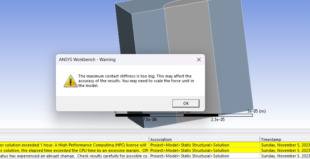

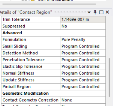

      I'm doing fiber push-out simulations and took the data from an experiment. I'm not able to match the results with the experimental findings as it says the contact stiffness is very high. However, the contact stiffness is program-controlled in my simulations, how can i change it?
      I tried changing it to an absolute value but i get an error when i run the simulations with any random stiffness value.
    • Ashish Khemka
      Please see if the following post helps: Maximum contact stiffness is too big (ansys.com)
      Ashish Khemka
    • mjmiddle
      This warning message is stating that the magnitude of the contact stiffness is a very large number, probably orders of magnitude higher than other stiffness values in the stiffness matrix.  Since very large numbers in the stiffness matrix can cause ill-conditioning when trying to solve the numerical system, this automated warning is recommending that you check your results to make sure they look ok, and that you consider changing the unit system to avoid very large magnitude numbers.  Ill-conditioning can occur when you have a matrix that has very large and very small numbers on the diagonal, say 1e20 and 1e0, and when the code tries to use this stiffness matrix to solve the problem, the small numbers essentially get wiped out.  This can cause convergence or accuracy issues.
      However, this is just an automated warning. If your analysis seems to be converging successfully, this warning may not be serious. If you review your results and verify that they are accurate, you can ignore this warning.
      To eliminate the error, the easiest thing to do is to use a different unit system.  For example, consider a stress of 145 ksi.  This same stress is 1e9 Pa (N/m^2), or 1 billion Pa.  Using Pa units, you can easily see that you may end up with some very large number magnitudes, and if they get large enough, there is a chance for numerical problems during the solve, and thus the automated warning.  This warning is not saying that your contact stiffness is incorrect, just that the magnitude is exceeding some internal magnitude that is considered a large number. However, if the analysis is running successfully, it is just a warning, you can just ignore.
      If this is the warning you get, then it gives a recommendation of using a different unit system during solution, which is exactly what you should do. Using a smaller length unit system, such as changing from meter to millimeters, will make the contact stiffness a smaller number by 1E9.  The contact stiffness has units with force/length^3, so smaller length values (mm->m) will increase the contact stiffness value. Note that using smaller force unit system (N->dyne) will make the contact stiffness larger. 1e5 dyne = 1 N. So changing unit system from m,kg,N to mm,kg,N decreases the contact stiffness by 1e9, whereas changing unit system from m,kg,N to cm,g,dyne only decreases the contact stiffness by 1E1 (decrease by 1E6 from m->cm with increase by 1E5 from N->dyne). Changing unit system from m,kg,N to um,kg,uN will decrease the contact stiffness by 1e12 (decrease by 1e18 from m->cm with increase by 1e6 from N->uN).  The warning is triggered when the initial contact stiffness value is 1E17 or larger.

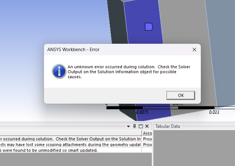

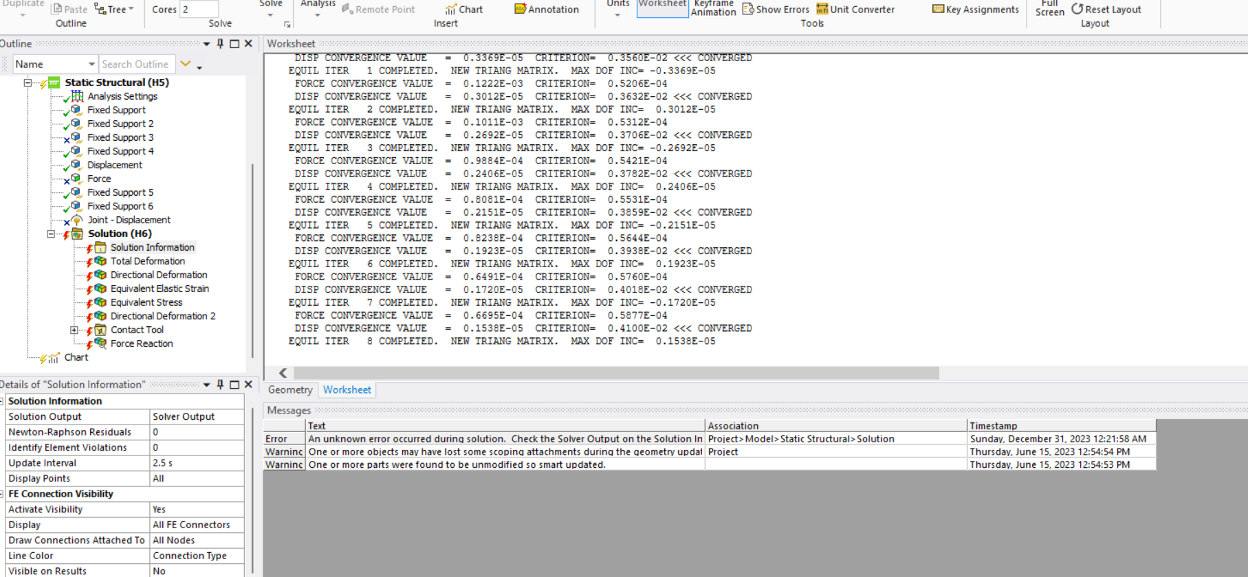

        Thank you for your reply. I changed the units accordingly as you said and now when i run the solution without changing anything except the units, I get an unknown error.
        in the solution information, there is no error as such
        what could be the further steps to solve this issue?
    • mjmiddle
      An abrupt end like that during an iteration with no message is normally a loss of license, or something killed or interrupted the process, like a machine reboot or a user manually killing your processes on a server machine or a 1-user machine where a remote login killed all processes of the current user when the login overrides the current login. Maybe Ansys run is from a served network and you lost network connection.
