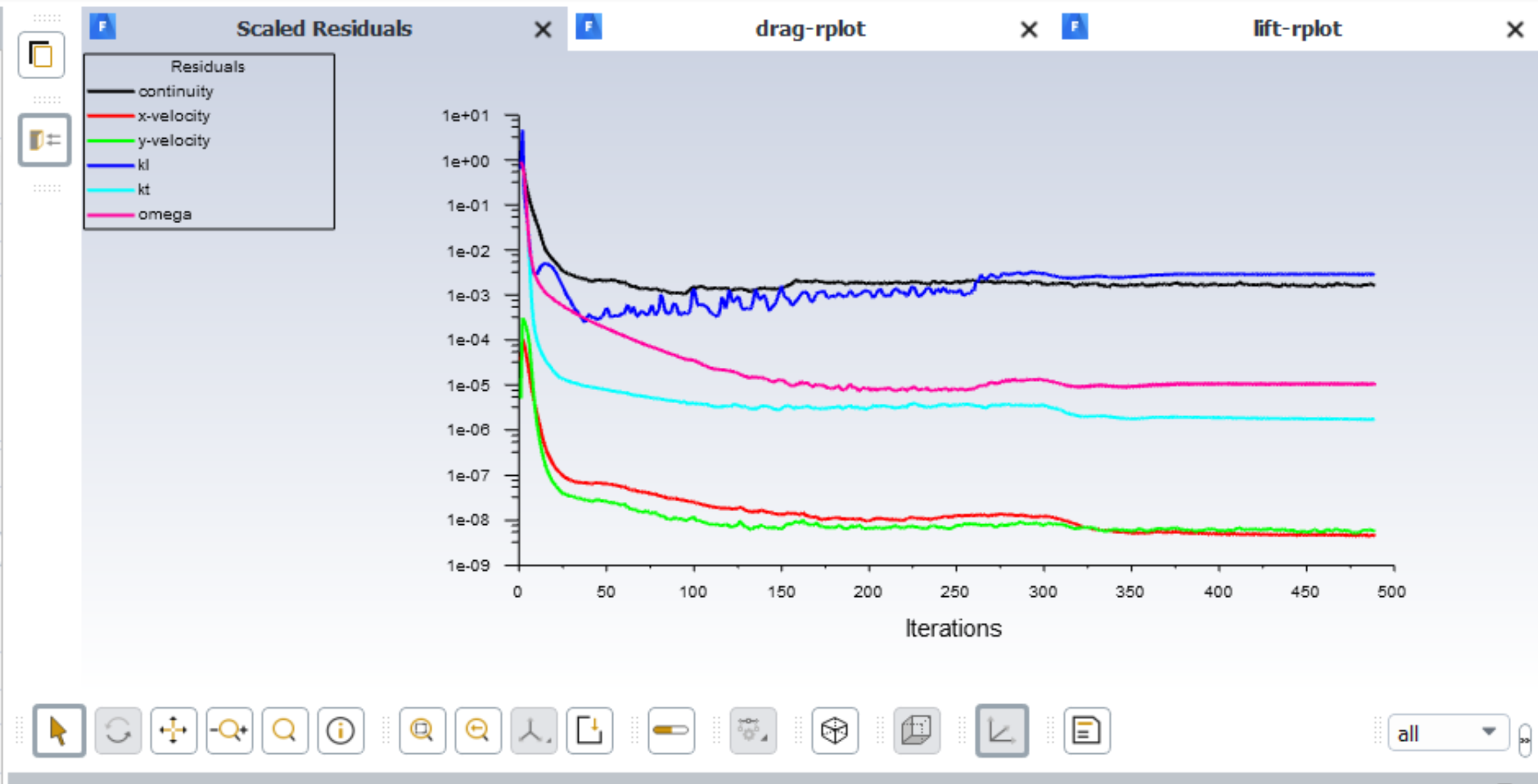

SubscriberHello Im using ansys 2020 R2 , Im modelling Naca 0012 at 0 AOA I got good results cd 0.0062 and cl 0.00007 , which is good, but when I canged the AOA to 3 degrees from the inlet velocity , I setit to "magnitude and direction" my manitude is the same 43.8 , x- component is sin3 and y component is -cos3 , I got very bad results CD went to 0.0011 and CL 0.17 which not logical or accurate, what can I be doing wrong.

Forum ModeratorIf you plot the velocity how does it look?
February 17, 2022 at 3:55 pmFebruary 17, 2022 at 4:27 pmRob
Forum ModeratorNo, the velocity vector plot. We can use that to check the flow is going where you think it is.
