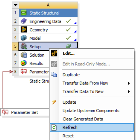

      You will need to right click to refresh the Model cell:
      If you run solutions by updating design points, the refresh is automatic.
