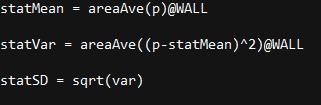

      Hi, this is Jimmy. I would like to calculate the pressure variance on a wall in CFX-post. As you know, we can input equation in function setting. But I can not find variance. I know this is not too complicated. So, give me some suggestion plz.
    • raul.raghav
      Jimmyhan,
      In CFD-Post, create the following expressions for mean, variance, and standard deviation respectively:
    • Jimmyhan
      Thank you so much! It really helps.
