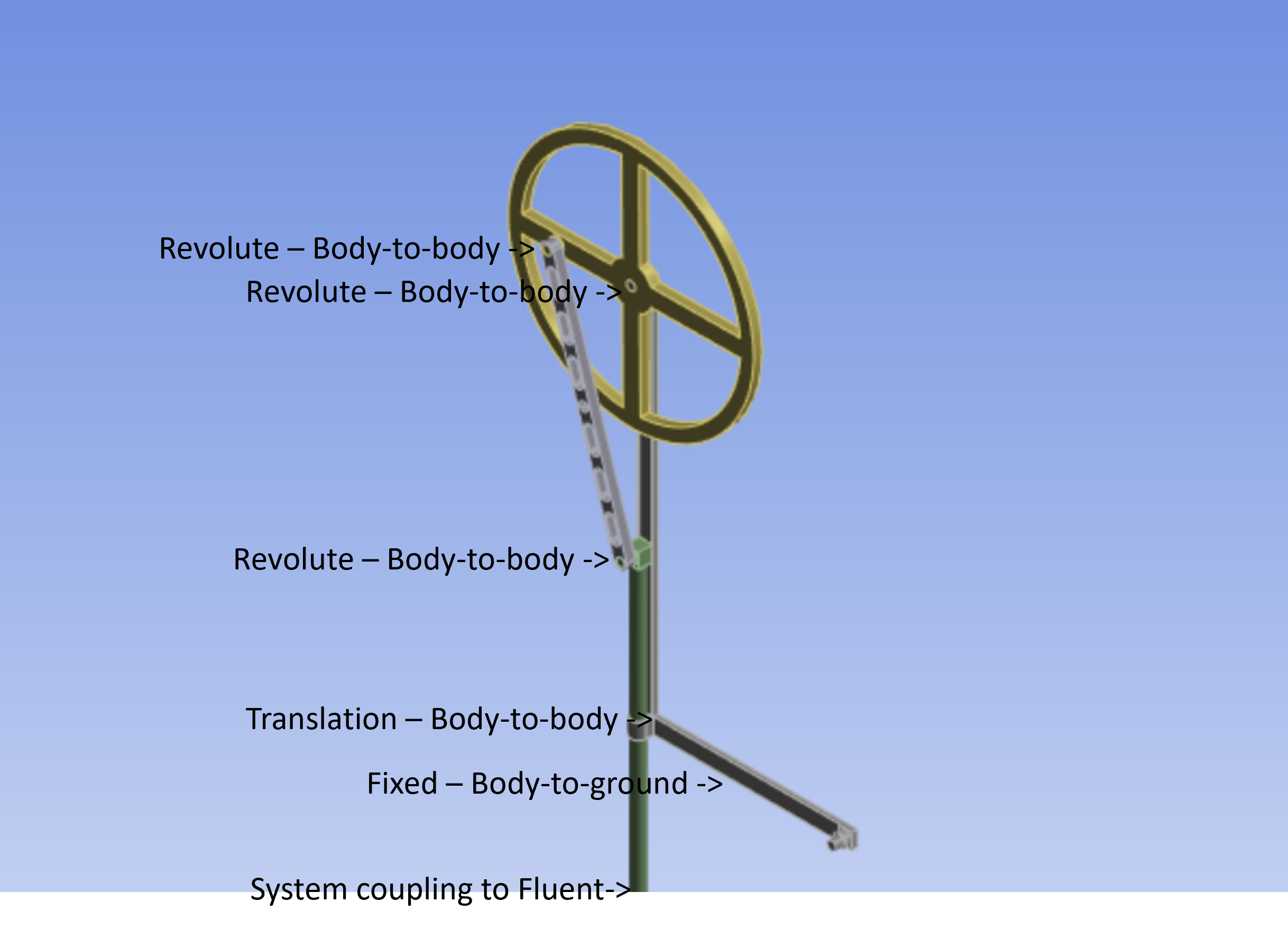

SubscriberHi. I have an eccentric wheel mechanism and I want to find the torque that the wheel can produce. It has a frame that has a body-to ground fixed joint that holds the mechanism. The frame is connected to a piston with a translational body-to-body joint, which is connected to a rod with a body-to-body revolute joint, which is connected to a eccentric pin on the wheel, again by a revolute body-to-body joint, finally, the center of the wheel is connected to the frame with another revolute body-to-body joint. The piston is moved through a system-coupling interaction with Fluent. Everything is working ok. I can run the simulation and get all the info I need except the torque of the wheel. I can get the displacement through a deformation result but I cant get the force. I tried using a probe for force and moment reaction but I can only use the geometry selection location method for a surface and the results don't make much sense to me. I have set everything to Yes in calculation settings - output controls. I want to have a transient analysis where I can calculate the torque, the displacement and the energy that I can generate with the wheel throughout the oscillation of the piston. What can I do to get these results? Many thanks

SubscriberYou can request the force going through the revolute joint on the arm of the wheel and the connecting rod. A similar force goes through the revolute at the other end of the connecting rod. With some vector math, calculate the angle between the connecting rod and the radial vector from the center of the circle to the point on the arm. Multiply the Total Force by the sine of the angle to get the tangential component of force and multiply by the radius to the point on the arm to get the Torque. When the angle of the connecting rod is 0 or 180 degrees, the Torque is zero because the sine is zero.

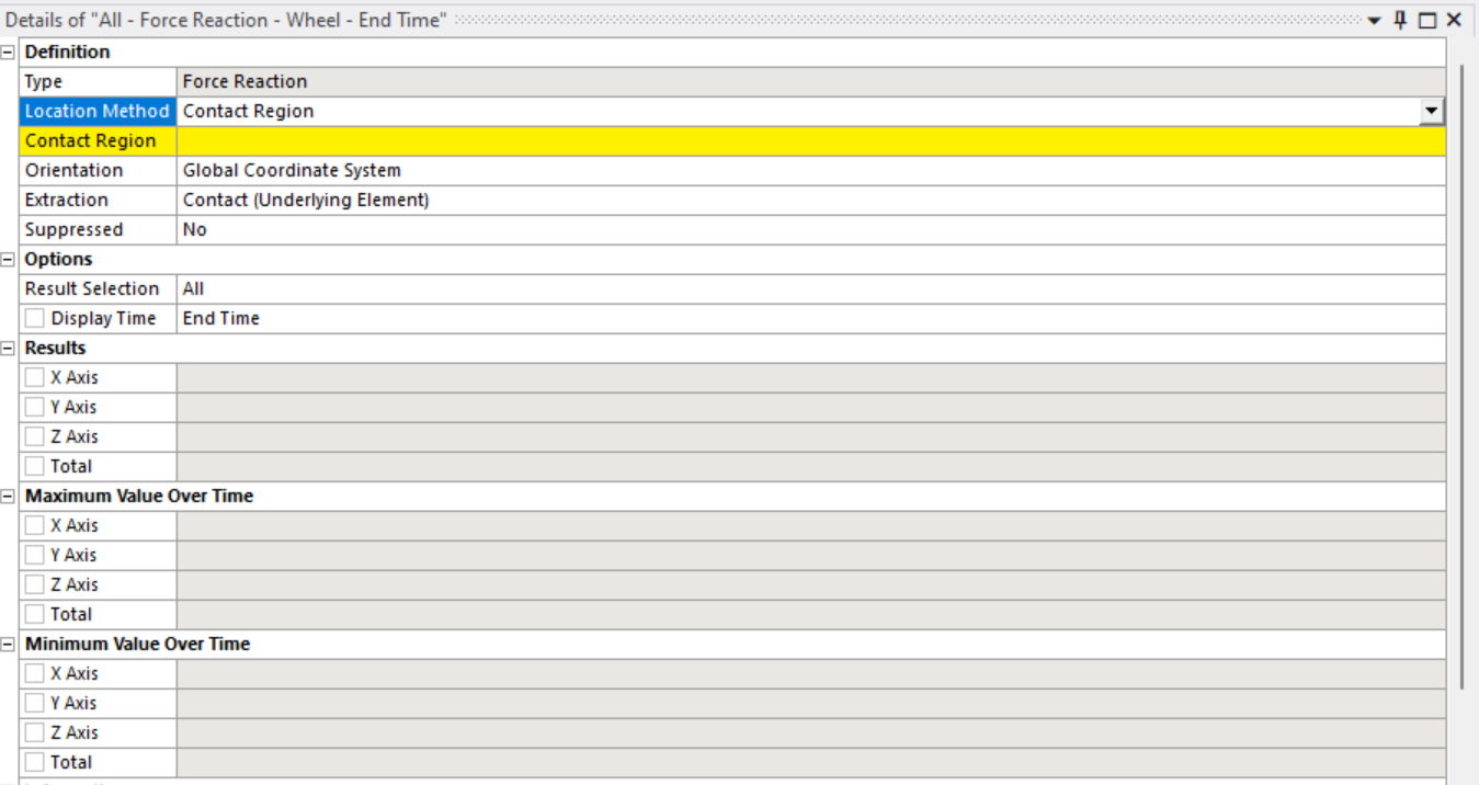

The trouble that I'm having is that I'm getting the force results with the "Location Method - Geometry" and then selecting the "Surface" of the frame where the wheel spins and the result is not making much sense to me, so I was trying to use another "Location Method" to see if the result makes more sense. If I get the force from the eccentric pin to the connecting rod I get the same results because I'm using the same location method. In the end, I want displacement, force, torque, work, power and energy over an entire oscillation. I'm also trying to work my way back from energy to force but my energy plot has more peaks and valleys than what I think it should... Can you point in any other direction to get these results, or to work my way from another result to these so I can compare and make better sense of them?Â

Here´s a screenshot of what I was trying to do, and I could't see any options for the yellow part:

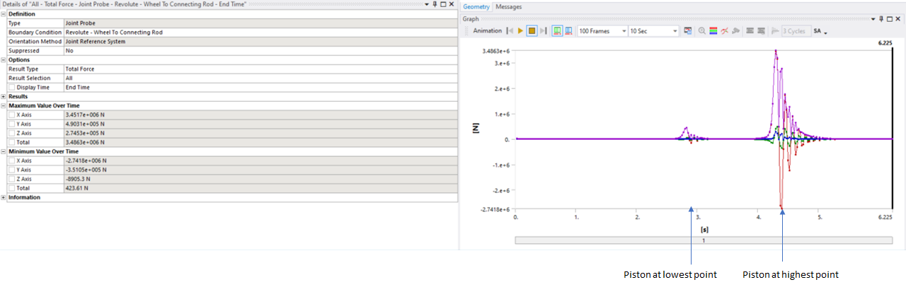

I then did what you said about draging the joint into the solution and got:

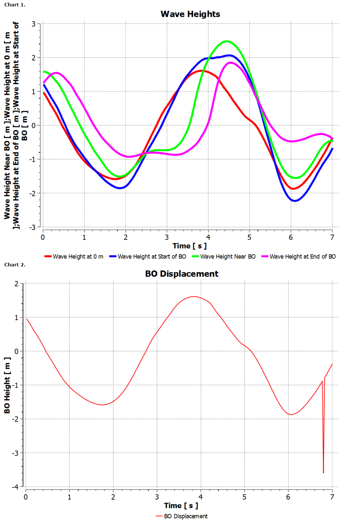

This result is making much more sense. It seems that the amplitude of the oscillation coming from Fluent is slightly bigger than that of the Wheel so a lot of the energy is going into bending the connecting rod and then it un-bends and bends again repeatedly making those peaks in the force plot. I was inspecting the wave amplitude and the float displacement in CFD Post and the wave’s distance from the crest to the free surface level without wave is a bit larger than the distance from the free surface to the trough so that would also explain why the peaks are larger on the crest than the trough. BO is Buoyant Object
