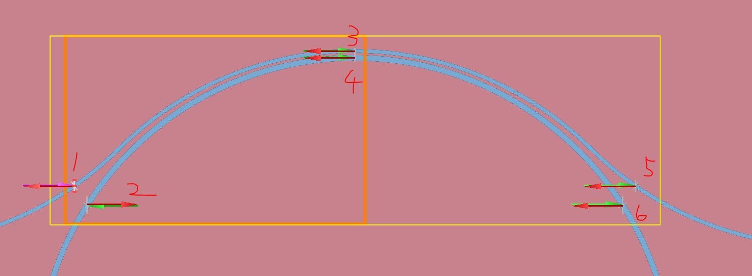

SubscriberHi, I want to calculate the transmission characteristics (transmission of the through/drop port) of the coupler shown in the attached figure by calculating only half of the coupler structure since the coupler is symmetric with respect to the x = 0 axis. Is it possible to deduct the transmission characteristics of port 5 and 6 by the S parameters of port 1-4? Thank you!
January 7, 2022 at 7:09 pmGuilin Sun
Ansys EmployeeI believe this is a more theoretical question other than simulation.
Sure you can simulate half the device, since it is symmetric. If at the ports there is only one fundamental mode, things can be much easier: from ports 1,2 to ports 3,4, you get the s parameters, and it is lossy, so you only need to double the loss will give you the transmission at ports 5 and 6. You could use transfer matrix or scattering matrix to get the exact results, since you know the s parameters at each port. You will need to flip signs for the second part. The details are up to you to develop. More modes would also work if you use more s parameters.

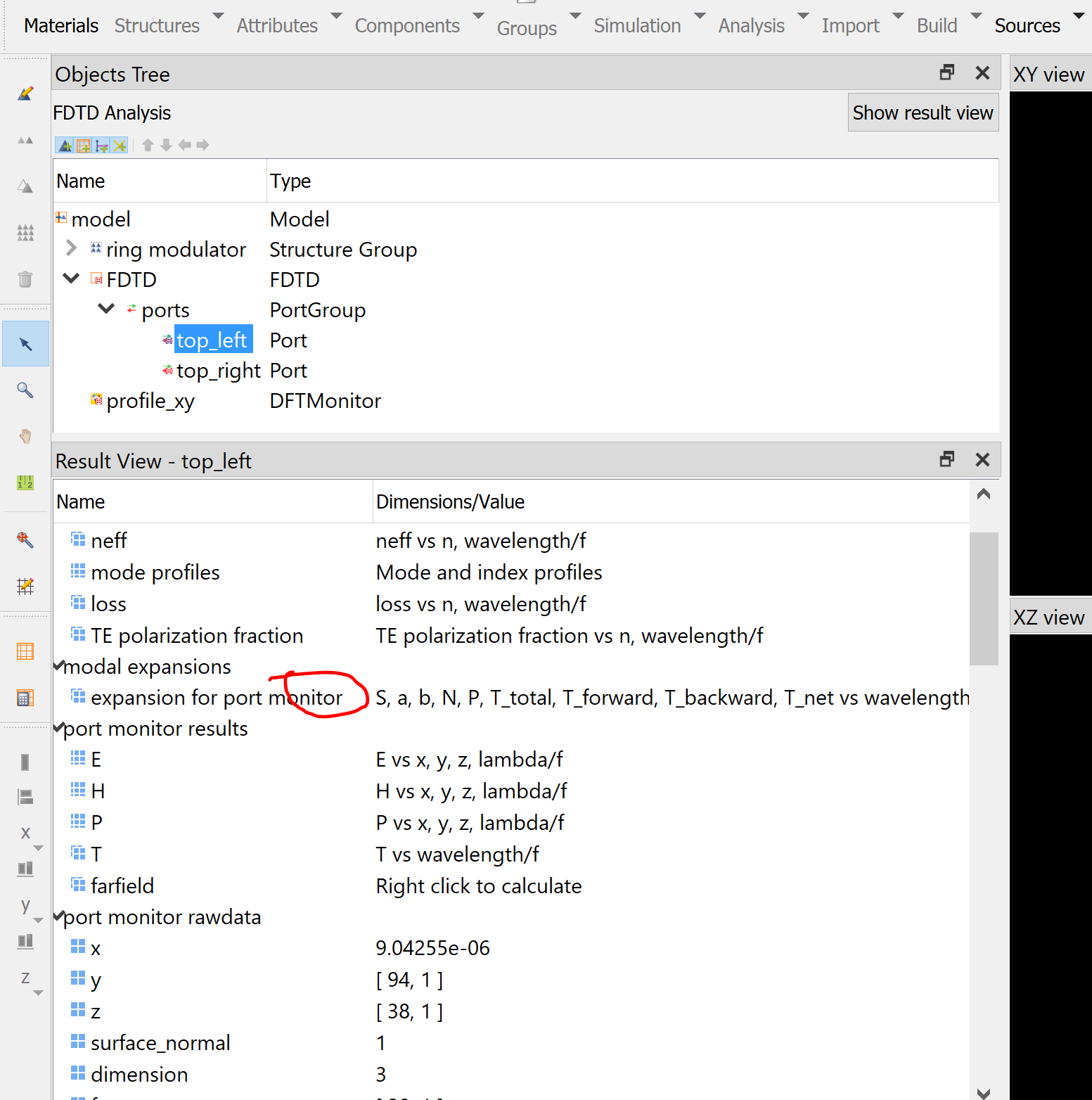

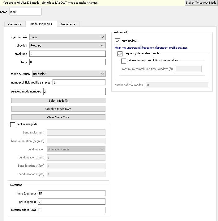

SubscriberThank you so much for your reply! I guess I am still a little bit confused about the parameters that can be extracted from the port expansion tab. For example, if I were to calculate the transmission of one specific mode of port 4 with the excitation only at port1, would that be T_in or T_out from port expansion of port 4? Or would that be abs(S)^2 of from port expansion of port 4?
January 18, 2022 at 1:11 amGuilin Sun
Ansys EmployeePlease refer this https://support.lumerical.com/hc/en-us/articles/360034902433-Using-and-understanding-Mode-Expansion-Monitors
abs(S)^2 is originated from S parameters.
But I am not sure where T_in and T_out are from. The regular port gives
Please get more information on mode expansion result here https://support.lumerical.com/hc/en-us/articles/360034902433-Using-and-understanding-Mode-Expansion-Monitors

SubscriberLike this one shows.
January 18, 2022 at 1:36 amxyjxyj1992
SubscriberAnd what does S exactly stand for in this "modal expansions" tab. The website you provided does not include the information of S.

Ansys EmployeeI am sorry that I do not know which example you are referring for the T_in, T_out. We have used the above T_forward and T_backward for long time.
S parameter is used to describe mode amplitude reflection/transmission (field) coefficients. It is originally from microwave network analyzer. You can find some textbook to get some details. It is similar to Fresnel coefficients in traditional optics. Since this is fundamental concept, Lumerical does not provide any background.

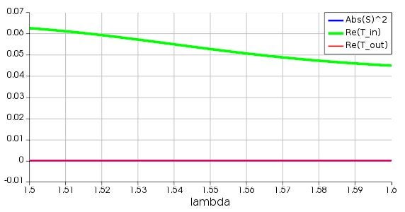

SubscriberThanks for the confirmation. I believe so too. Please correct me if I am wrong, if the injection direction of each port is forward. Should the transmission of top right be equivalent to T_in instead of T_out?
January 19, 2022 at 1:17 amGuilin Sun
Ansys Employeemost likely T_i is the T_forward, which means towards positive axis. You may infer this with their values, in and out can have significant difference. Each port will have T_in and T_out, which means T along positive and negative axis directions. Whether it is transmission or reflection will depend on the source injection. In addition, you may need to use your experience to deduct which quantity it refers. Port quantities are in general, it does not know the source injection is along positive axis or backward.

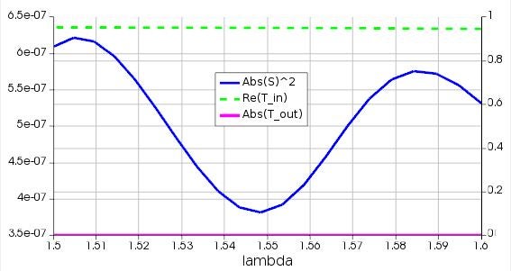

January 19, 2022 at 2:03 amxyjxyj1992
SubscriberJanuary 19, 2022 at 4:50 pmGuilin Sun
Ansys EmployeePlease ignore the difference of 1e-8. the bottom result shows you correctly to separate them.

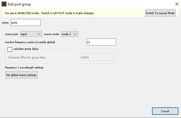

Not sure how to you excite the ports. But please use larger port size to capture the whole mode profiles. In particular port # 1,2 and 5,6. You can use a profile monitor to check what the fields look like at ports.

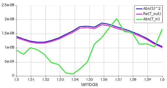

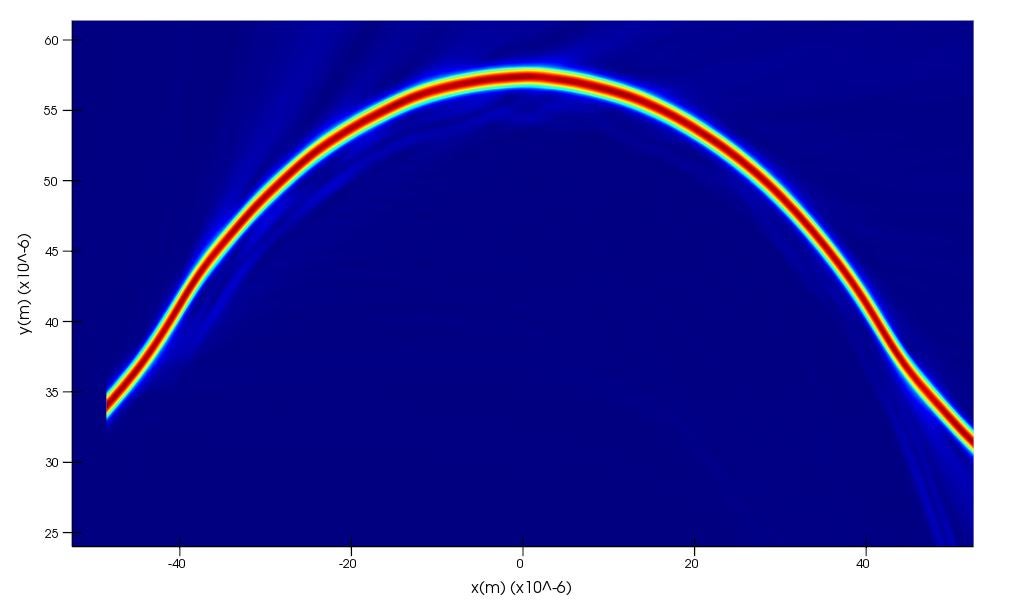

SubscriberHi, I did another test yesterday. The results of abs(S)^2 and T_out are definitely not correct. As you can see from the E-field monitor, the majority of the power goes through port 5. However, abs(S)^2 and T_out of port 5 is basically zero (abs(S)^2 and T_out corresponds to y left axis while T_in corresponds to y right axis). Can you check and verify it with me since it is very important? Thank you!
January 21, 2022 at 11:32 pmGuilin Sun
Ansys EmployeeT_in and T_out may not well be defined. If T_out does not match abs(S)^2, please check T_in.
January 22, 2022 at 2:12 amxyjxyj1992
SubscriberSorry about the confusion. As the results show, T_out matches with abs(S)^2 but they are not supposed to be the answer for the transmission of port 5. Since the E-field diagram clearly shows that the majority of the power goes through port 5, which means that transmission should very close to one and that matches with T_in. However, T_in does not match with abs(S)^2 at all.
January 24, 2022 at 5:21 pmGuilin Sun
Ansys EmployeeT_in and T_out do not have a definite definition right now. Currently only T_forward and T_backward are clearly defined. I would suggest that you use the variable that gives you correct result, disregard its "appearing" definition.
