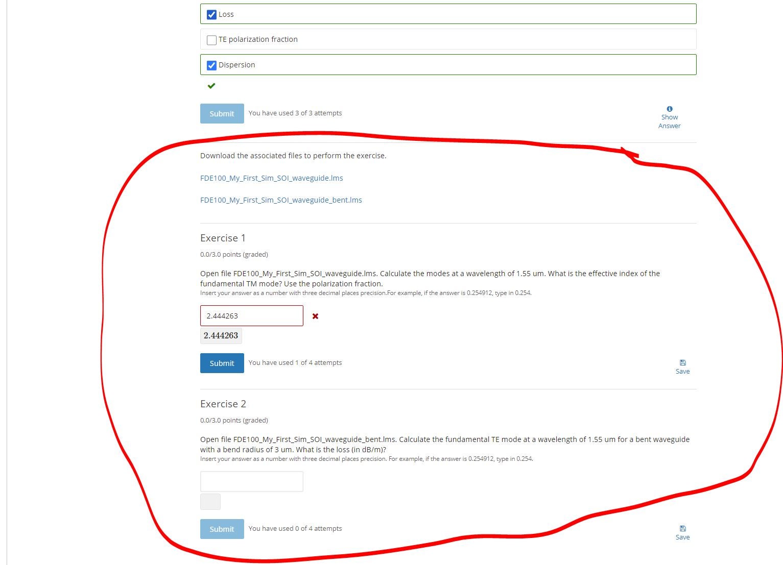

SubscriberI am taking the FDE Solver Course and am stuck in the "My First Simulation" Quiz and Exercise where I download the associated files to perform the exercise. I trying to understand how to get the correct answer for Exercise 1 and 2. I changed the wavelength to 1.55 um, but I don't know what to do next and how to analyze the results. I am pretty much a novice in photonics. Could I do a Webex or something so someone could walk me through this?

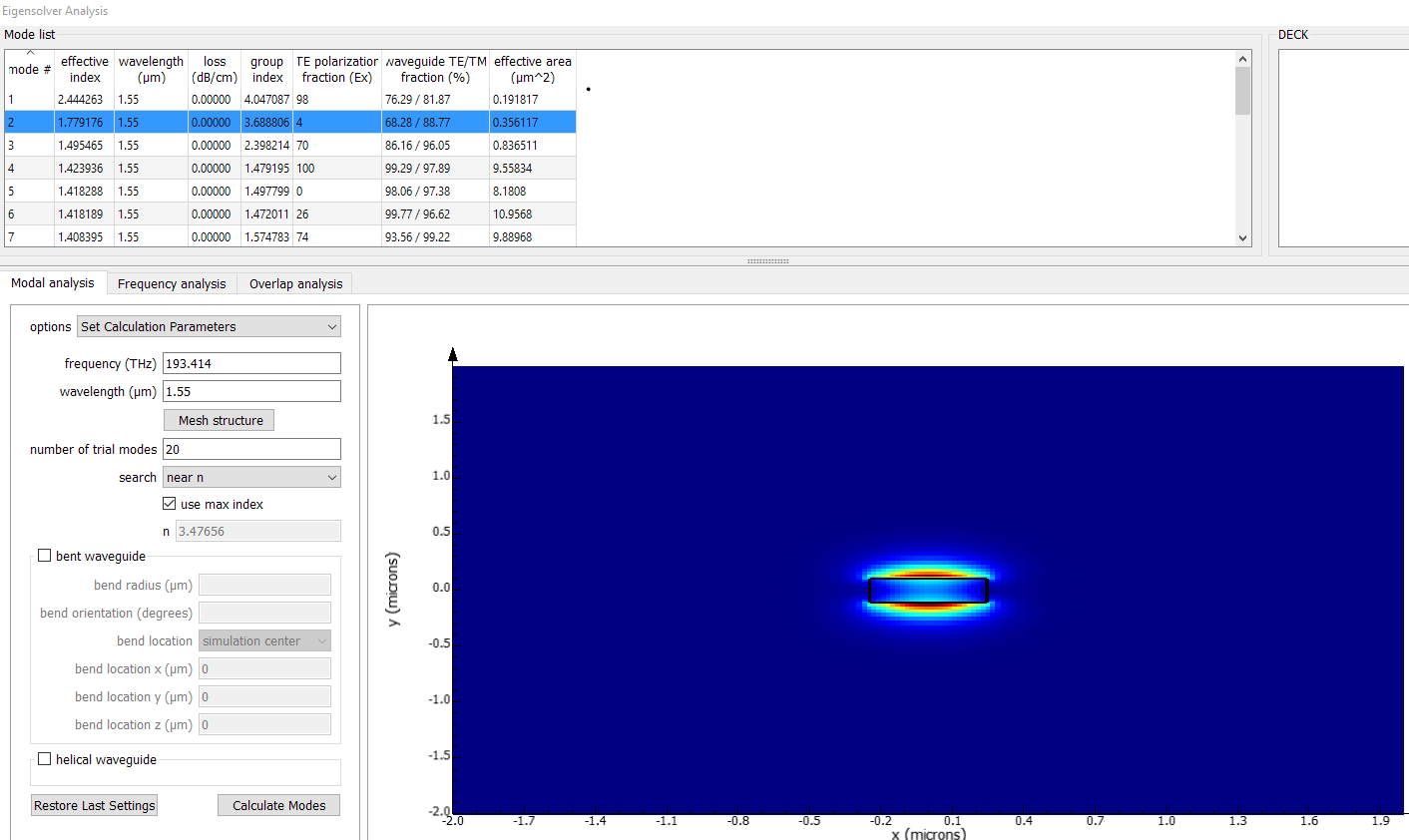

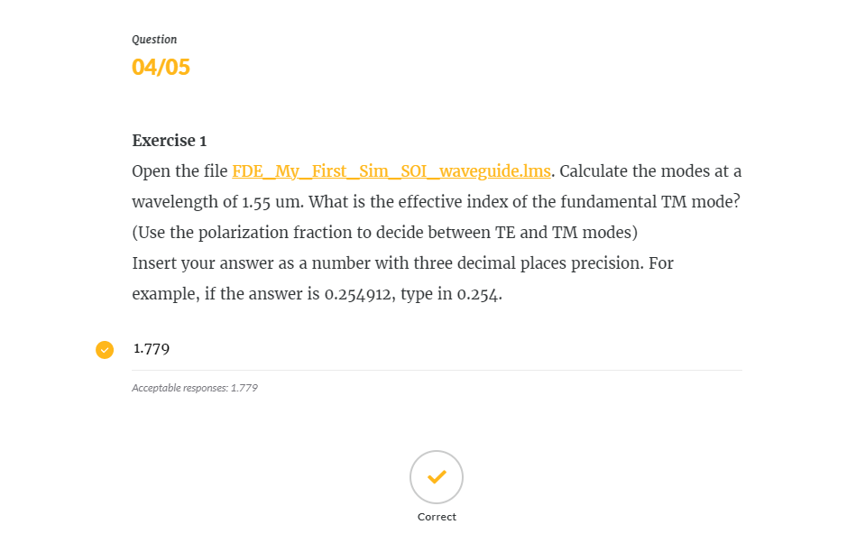

This question is asking for the fundamental TM mode, which you can tell by looking at the TE polarization fraction. This is a pretty standard SOI waveguide geometry where TE is fundamental and the second mode will be TM.
So you just need to use the effective index of the second mode on the list. You can find more info on the quantities here https://support.lumerical.com/hc/en-us/articles/360034396734-FDE-solver-analysis-Mode-List-and-Deck.
