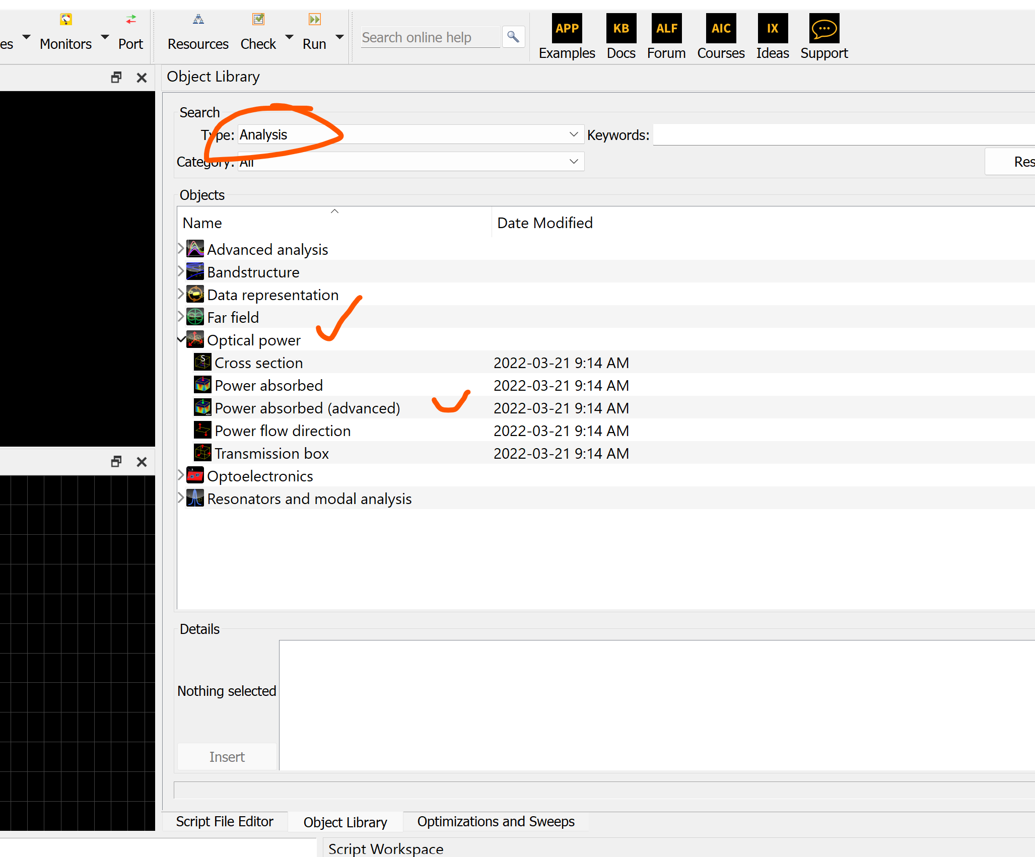

I want to calculate the absorption in some volume and poynting vector in spcific positons. is there any function or codes that I can use for these purpose?
May 29, 2023 at 5:59 pm
Guilin Sun
Ansys EmployeeThe frequency-domain monitor has built-in Poynting vector of Px,Py and Pz. you can specify the monitor to the specific location.
For absorption, if you want the total ratio, you can use 1-R-T where R is the reflection, and T is the transmission. If you want to calculate loss in a specific volume, you can use analysis group :
