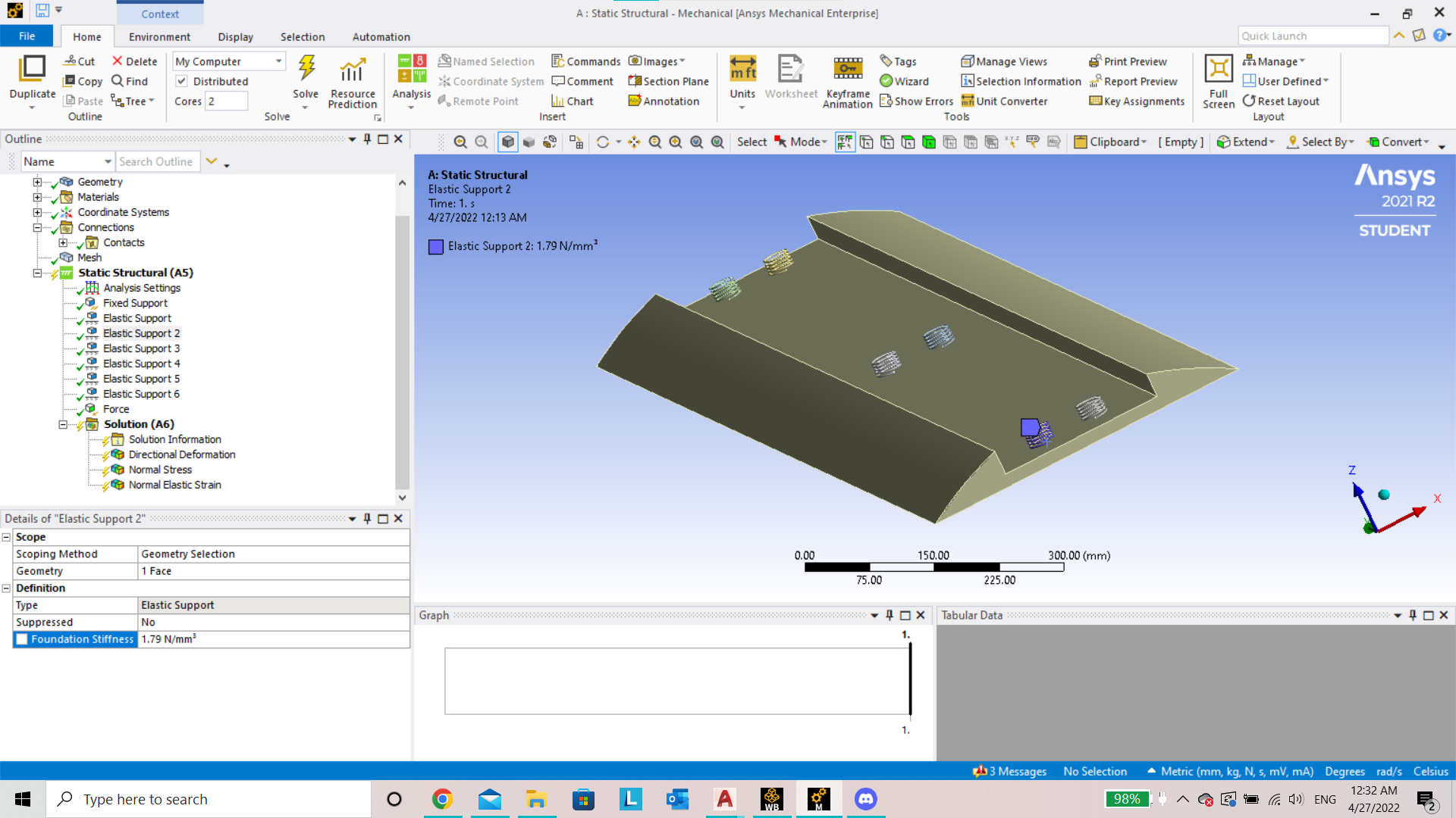

SubscriberI am currently simulating a piezoelectric speed bump that generates electricity when a car drives over it.
The surface is supported by springs. I defined these springs as Elastic support and i know their Stiffness in N/mm. However, the foundation stiffness is in N/mm^3. How can to convert the stiffness to foundation stiffness and is my method of support is correct?

April 28, 2022 at 1:24 amAhmadhajj
SubscriberHey I have a students license so i cannot enter the link you sent me. I tried the steps you sent but its not working for me.
Thank you
