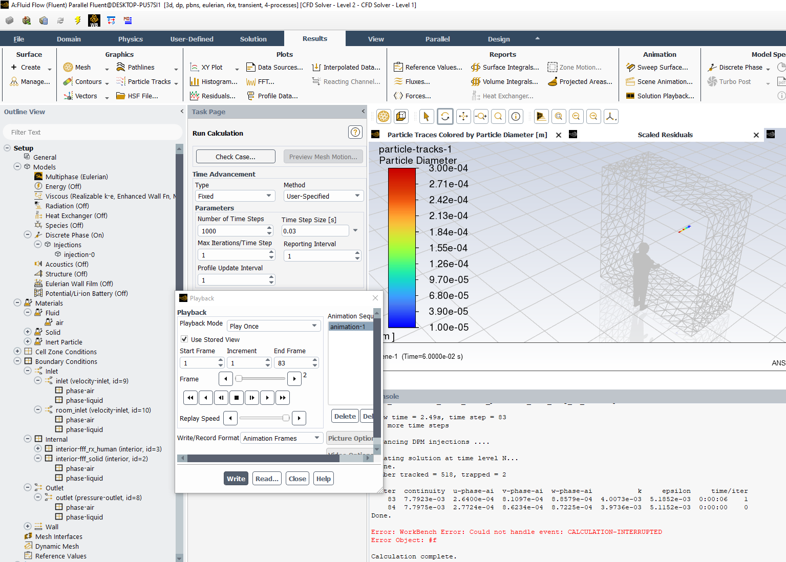

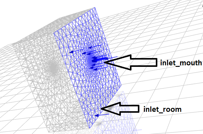

February 2, 2022 at 3:01 pmfatih_g
SubscriberThank you for the answer. As you suggested, I removed the multiphase model. As illustrated in the figure below, I already inject particles from the inlet_mouth. I also added an airflow from the same inlet_mouth. Now if there is not any ambient airflow from the inlet_room which is a velocity inlet in the same direction with the particle injection, everything is fine. But if there is an airflow from the inlet_room, the particles are absorbed back to the inlet_mouth in a few time steps.
So, how can I create a constant ambient air velocity from the inlet_room without this vacuum effect? Is it related with the gauge pressures defined at the boundaries or the inlet types or any thing else?
February 2, 2022 at 4:53 pmRob
Forum ModeratorI'm not sure why you've got a refinement zone on the outlet side. Setting two velocities is OK, but run without particles and see what the flow is doing. From there we can figure out what's going on. We'd usually add the particle source into the domain, and it's rare to have a room open like this.

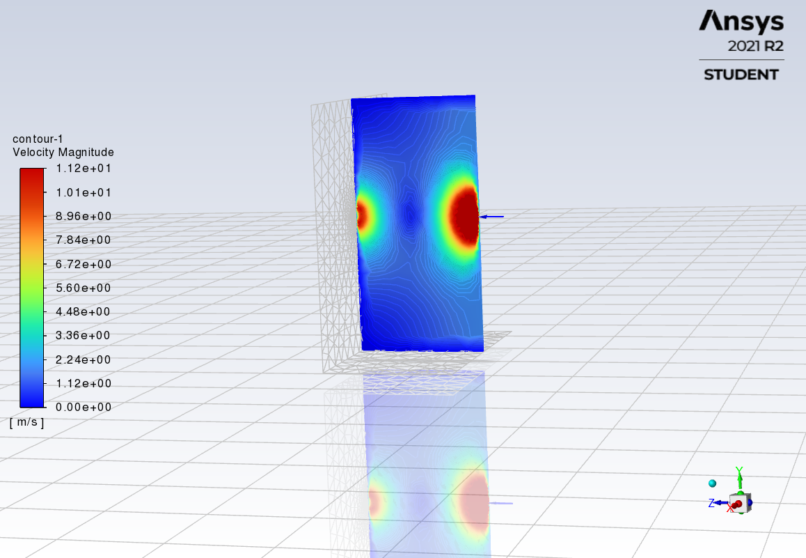

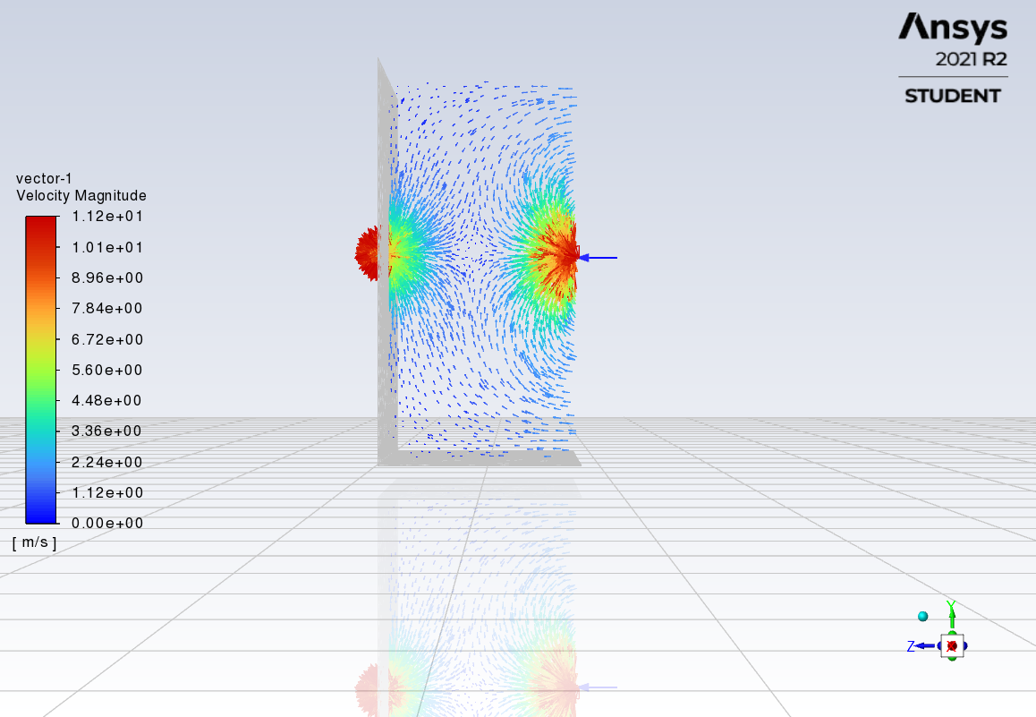

February 3, 2022 at 1:59 pmfatih_g
SubscriberDear Rob,
You can find the velocity contour and vectors below. Here, 800 particles and air are injected with a velocity of 11.2 m/s for 0.12 s from the inlet_mouth. The velocity from the inlet_room is defined as 2 m/s. In this scenario, particles are absorbed back into the inlet_mouth as soon as they are injected. Also, the surface on the left just across the inlet_mouth is my outlet where I want to count the particles. If I define this surface as a pressure-outlet, the injected particles are quickly absorbed by this outlet surface.
February 3, 2022 at 2:31 pmRob
Forum ModeratorI'd expect a velocity inlet at one side (low z?) and pressure outlet at the +z side. I don't understand why there's a suction effect at +z unless you set velocity boundaries at both sides?

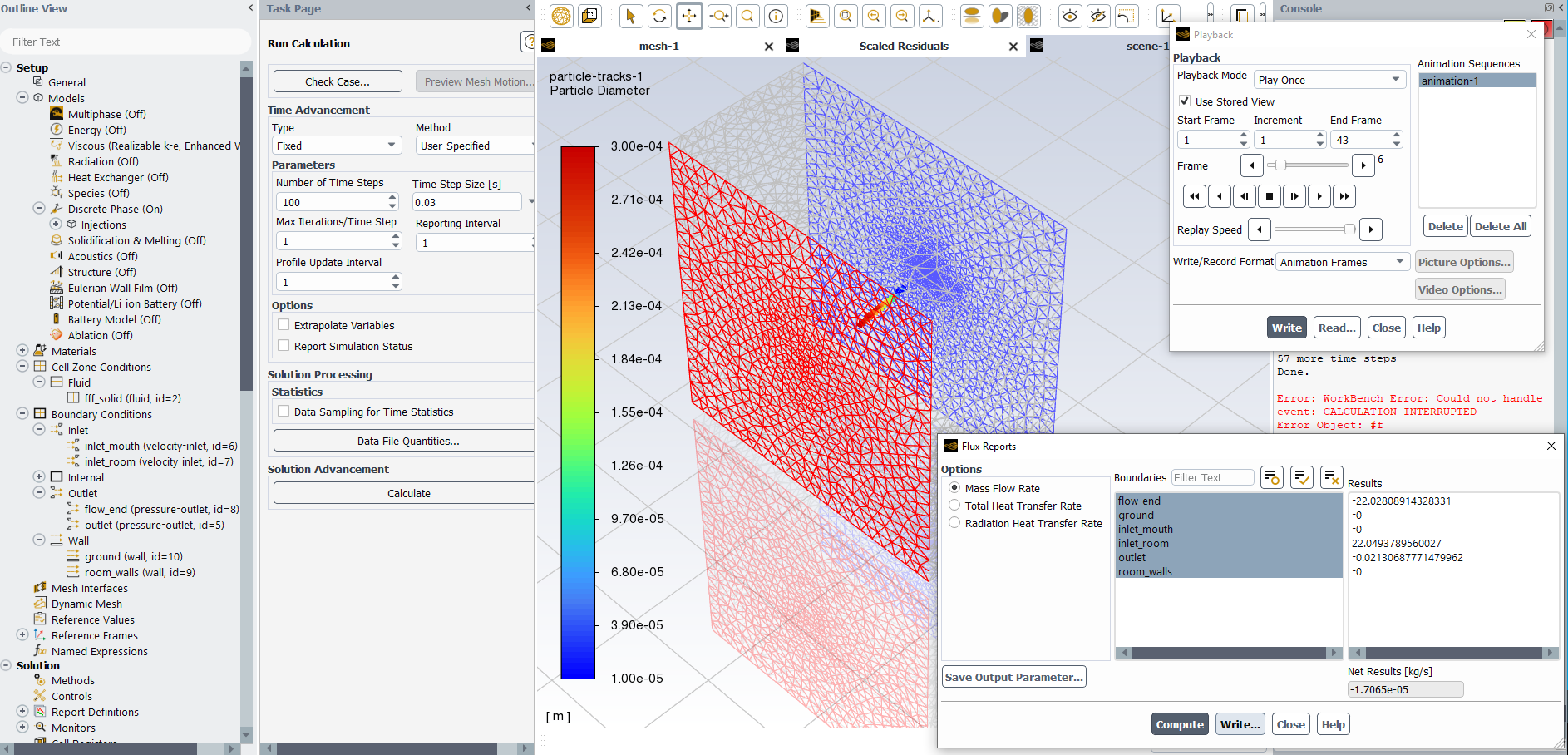

February 3, 2022 at 4:50 pmfatih_g
SubscriberI configured the back wall also as a pressure outlet and checked the mass flow rate values as you can see below. When I define a pressure outlet, particles are quickly sucked to the wall. When I define these outlets as wall, the particles are sucked back to the inlet_mouth again. There is nothing to hit in the flow domain. It's just a cuboid.
February 3, 2022 at 5:16 pmRob
Forum ModeratorLooking at that, inlet mouth is zero flow, and most of the mass leaves through flow_end rather than the outlet. Switch to steady and release a continuous cough/sneeze and let's see what happens.
February 11, 2022 at 1:41 pmfatih_g
SubscriberWhen I set the flow_end, which is at the whole surface except the 'outlet' on the left side, as the second outlet, the problem is solved. But if I set the circular 'outlet' surface as the only outlet, then there is a vacuum effect. Thank you.
February 11, 2022 at 3:31 pmRob
Forum ModeratorIf "outlet" is the only pressure outlet then all of the flow must leave the domain through the tiny surface.
