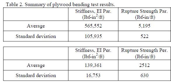

      Hello Sujaysanjiv,
      We use plywood to build single-use shipping crates to hold our products that we ship around the world.
      I wanted accurate material properties for the 4 x 8 foot plywood panels that our custom-designed crate is made from to use in an Explicit Dynamics simulation of some parts of our shipping test.
      I purchased ASTM D3043, Standard Test Methods for Structural Panels in Flexure. That standard describes four methods to test samples cut from panels. One aspect of plywood is that it can have knots and other defects in the panel. If you test a large enough sample, those flaws are too small to have a large impact on the test result. Some test methods use a much smaller sized sample, so those samples have to be free of defects so as not to skew the result.
      I found a vendor, Timber Products Inspection, Inc. in Georgia, who had the equipment to test 4x4 foot samples (half a panel) in a pure bending machine, a Metriguard Model 830 panel bender. I purchased 10 panels and had them shipped to the testing facility. They cut them in half and tested 20 samples to give me the average and standard deviation of the bending stiffness and rupture strength.
      The panels were tested parallel and perpendicular to the long dimension of the panel. This is not the 6-ply quality plywood you will use. This is cheap plywood used for single-use crates. You can see a significant difference in bending stiffness and rupture strength in the two directions. This resulted in an orthotropic material model in the simulation.

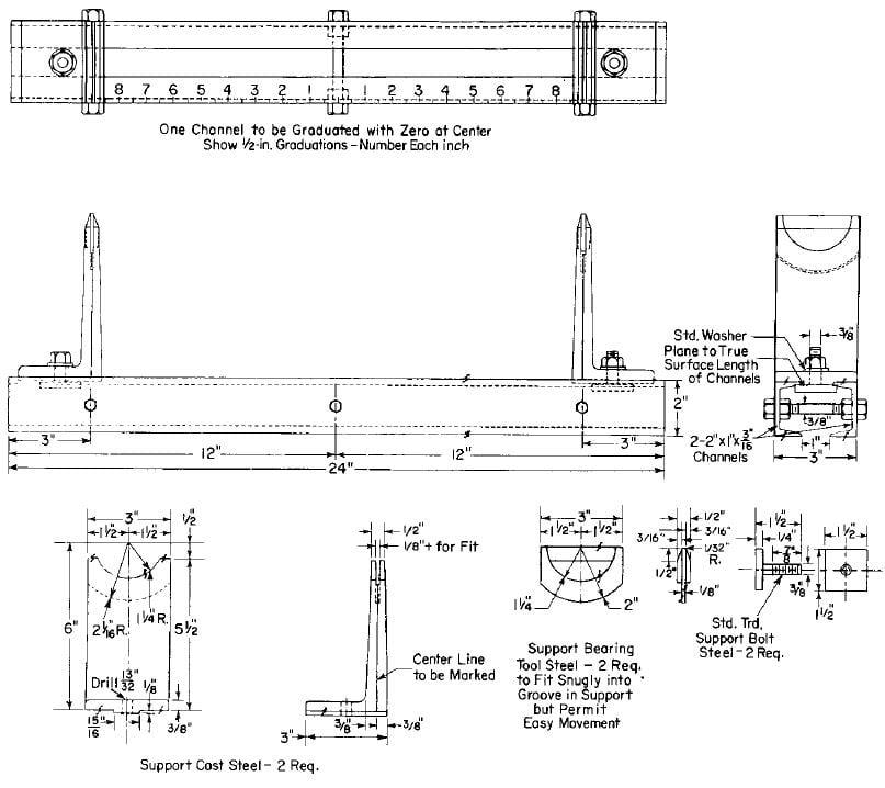

      Looking at the testing apparatus in your picture, it looks like it has a short span, which means it will induce significant shear loads into the sample. More importantly, the apparatus you show does not have the rotational freedom of the end supports called for in ASTM D3043 that is needed to allow for a warped sample so that it is uniformly loaded. The first image shows an end support with a sliding interface.
      The second image is an end support that includes a large roller bearing.
      If you have the budget to go to a panel testing lab, you will get reliable information. If you are limited to in-house testing, you should think about adding a degree of freedom to the end supports.
