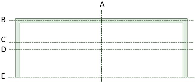

SubscriberDoes pinned mean a rotational axis of freedom? If so where is that axis?
In the figure below are five choices places you could put the axis of the pin.
Each location will result in a different buckling load. Where do you want the pin?
Note that some people use the word pinned for what is basically a spherical joint. Is this what you mean?
If so, where is the pivot point of the sphere in the figure above?

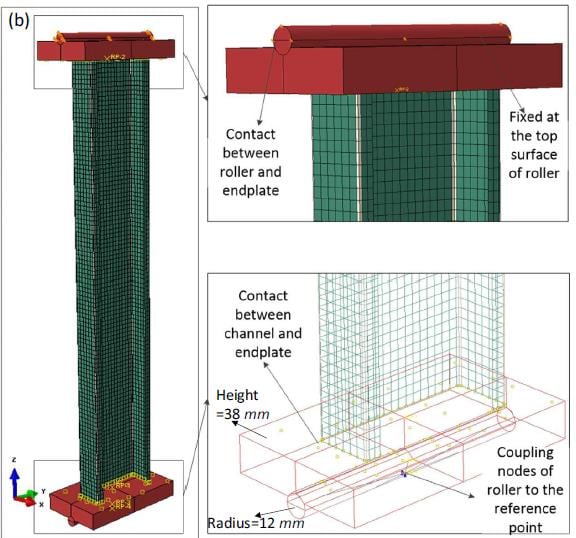

SubscriberHi, thanks for all this. Basically that's the channel column I intend to use and find critical buckling. I'm trying to apply similar condtions as the paper ("local-flexural interactive buckling of standard and optimised cold-formed steel columns ") which is online. The carried out expermential test to find the critical buckling and then used fea to to conduct the same test but I tired many things but I just can't seem to get the right pinned end condtions on the top and bottom end of the channel which will be d in the diagram you have drawn and also I just use 1N force for simplicity. Can you please help me and show me how to get same results as the authors in the paper using fea ansys. Thank you very much, I really appreciate it. -

SubscriberIn my figure above, I showed axis C going through the centroid of the cross sectional area, which is the neutral axis of the column. I thought you would choose that axis.

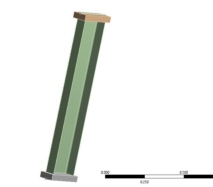

I looked at the paper and they show a FEA model with a shell model of the channel, which means a surface model of the geometry. The channel makes contact with an end plate, the endplate makes contact with a roller and the roller is fixed.
Can you construct the five parts shown above in either DesignModeler or SpaceClaim?

SubscriberYou can shortcut the approach used in the paper and suppress the bottom cylindrical roller body. You will instead use the cylindrical face on the bottom plate.
However, on the top cylinder, you need to split the face using a horizontal plane through the center of the cylinder.
In Mechanical, create a Joint, it will be Body-Ground and the type is Revolute. Select the cylindrical face on the underside of the bottom plate. That is your first pinned connection. You also have to create Frictional Contact between the bottom of the C channel and the top of the bottom plate.
The top needs two joints. Create a Revolute Joint between the bottom face of the cylindrical rod and the cylindrical face in the top plate. Next select the face at the top half of the cylinder and create a joint between body and ground. Set the joint type to Translational. You will have to click the + sign to access the coordinate system that was created by the joint and edit that coordinate system to make the X-axis point along the column length. Insert a Joint Load and set the type to Displacement and set the number of mm you want. You also have to create Frictional Contact between the top of the C channel and the bottom of the top plate.
This is a system that you can solve, but it will be best to insert a Contact Tool under the Connections folder and Generate Initial Contact Information. Check to see that the two frictional contacts are closed. Next, under Analysis Settings, set Auto TIme Stepping to On and set the Initial Substeps to 100, Minimum Substeps to 100 and make the Maximum Substeps to 200. Then set Large Deformation to On and solve.

SubscriberIn the figure below, there is a cross-sectional area shaded in light green. The centroid of that area is at the point at the intersection of lines A-C. The centroid is the neutral axis for beam bending. The line D is half-way between the top and bottom of the C channel and is not on the neutral axis but is eccentric from the neutral axis.
If you study column buckling, you will learn that as the load is applied with larger values of eccentricity (the distance from the neutral axis to the loading axis), the buckling load will reduce. The highest buckling load is with zero eccentricity, or the load passing through the neutral axis, which is at the centroid of the cross-sectional area.

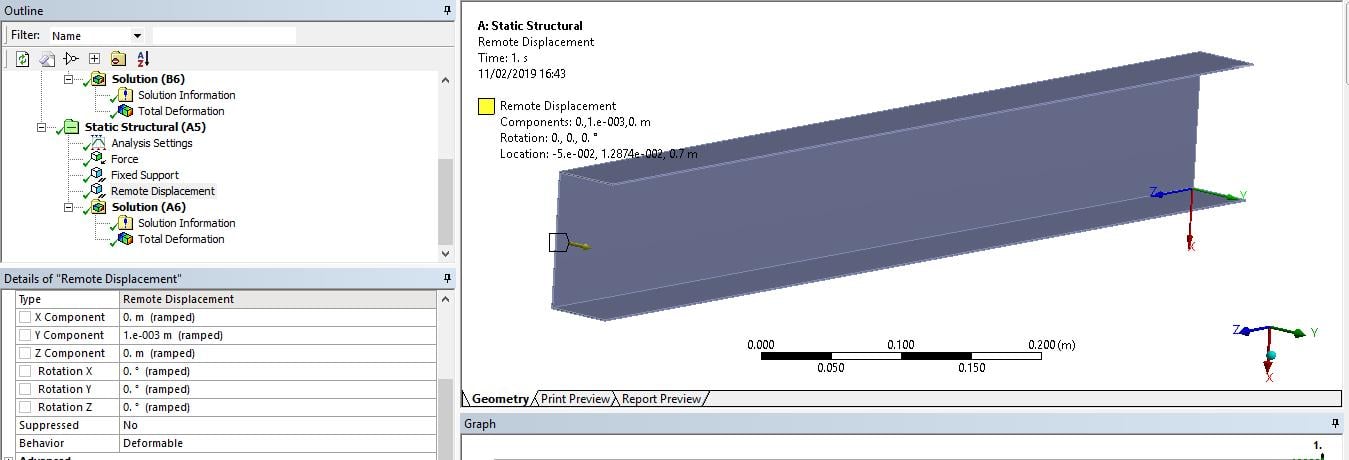

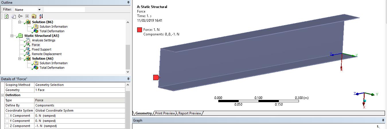

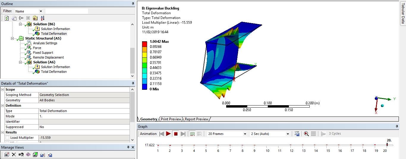

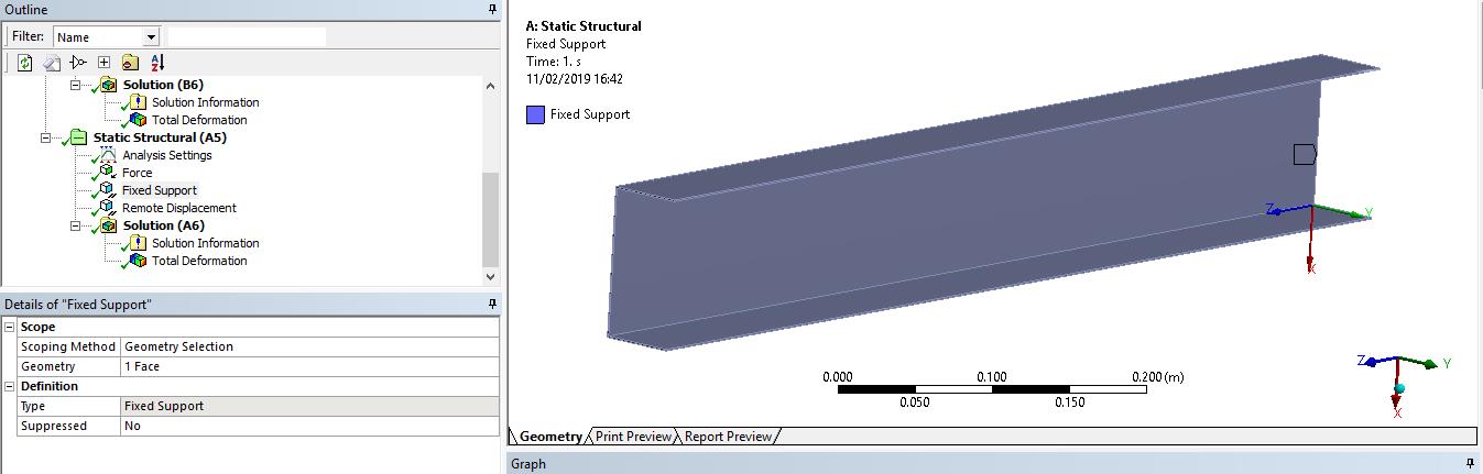

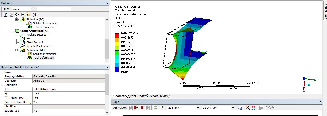

I followed your fix to fix advice and used it on a shape without any of the blocks as this is a different paper. I have attached the pictures for the fix, remote, force , deformation and critical buckling. Sir is this correct way to carry out fix to fix ends buckling in ansys and also you will see that there is small arrow to where each thing was applied.
February 11, 2019 at 5:04 pm
peteroznewman
SubscriberI edited my post above, please reread it. Now it applies a force so you can do the Eigenvalue Buckling solution. Applying a displacement is more useful to find the nonlinear buckling solution. I think you should keep the blocks at each end from the first paper. You will have to use Bonded Contact to do an Eigenvalue Buckling solution, I don't think it will let you have frictional contact.
