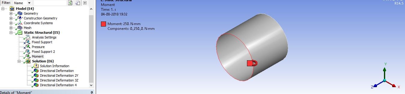

SubscriberHi Devaiah,
Sandeep says to use components, which is useful, but he describes a moment that would twist the tube along its axis.
Your sketch looks to me like you want to apply a moment to the edge in a way that would turn the tube inside out, or begin to roll it down its length. I don't know of a simple way to do that. It is simple to define a cylindrical coordinate system and apply a radial force to stretch the opening of the tube radially.
An inelegant and imprecise method is to slice the tube up and apply individual moments to the edge segments using components. I made 4 slices to get 8 edge segments and applied a moment to two of them.
I hope someone will reply with a more elegant way to to that.
Peter
ANSYS 19.1 archive attached.

But the problem as I mentioned above is that the moment should act normal to the surface at each and every point along the edge.
By using components, it satisfies the normal condition at only one of the points along that edge as shown above.

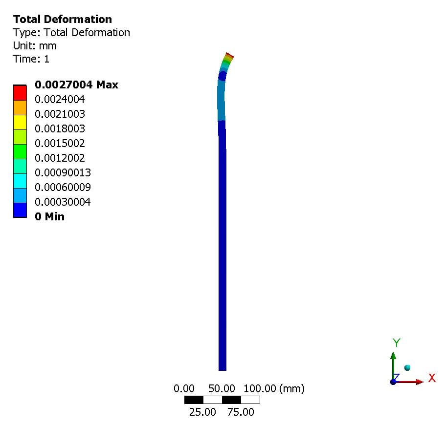

SubscriberHere is the axisymmetric model. I had to create a surface, but then I could apply a moment to the edge.
If you revolve this result around the axis, that is the 3D solution.
The point the author is making in the book is that these moments (and shear forces that you didn't mention) die out quickly and can be neglected compared with the other terms in the analytical derivation.
Peter

Devaiah
SubscriberHey Peter,
Thanks a lot.
I'd been stuck with this for more than a week now.
Really grateful to you.
