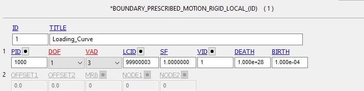

September 1, 2023 at 8:45 pm
yingtao

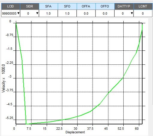

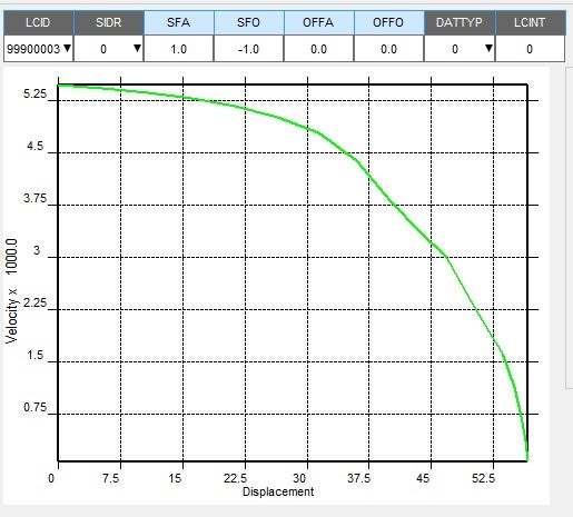

SubscriberHello, I have a Displacement-Velocity curve need to load into the model, I defined *Boundary_Prescribed_Motion_Rigid_Local, local coordinate and VID, added *initial_velocity_generation, *Boundary_SPC need to be added, otherwise the motion can not be in one direction and isn't correct, but still I can not get the correct motion. I tried to modify the input curve to start from 0, still it doesn't work. Can you give some advice about this?Â
September 1, 2023 at 9:22 pm
Reno Genest
Ansys EmployeeHello Ying,
The DOF parameter is set to 1 on your *BOUNDARY_PRESCRIBED_MOTION_RIGID_LOCAL card and so the motion is in the X direction. You don't need VID in this case.
What is the problem exactly? What do you mean by "I can not get the correct motion"?
Reno.
September 1, 2023 at 9:31 pm
yingtao
SubscriberHi Reno,
The pulse is applied in Y direction so I used DOF 1 and VID (VID X= global Y). But I tried global coordinate in Y direction the result is same. Yes, my problem is I can't get the correct motion, the velocity and displacement output of rigid body don't match with the input.

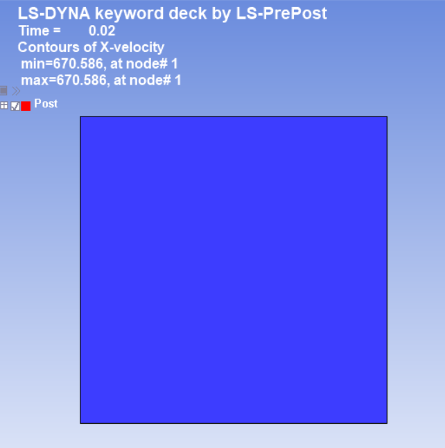

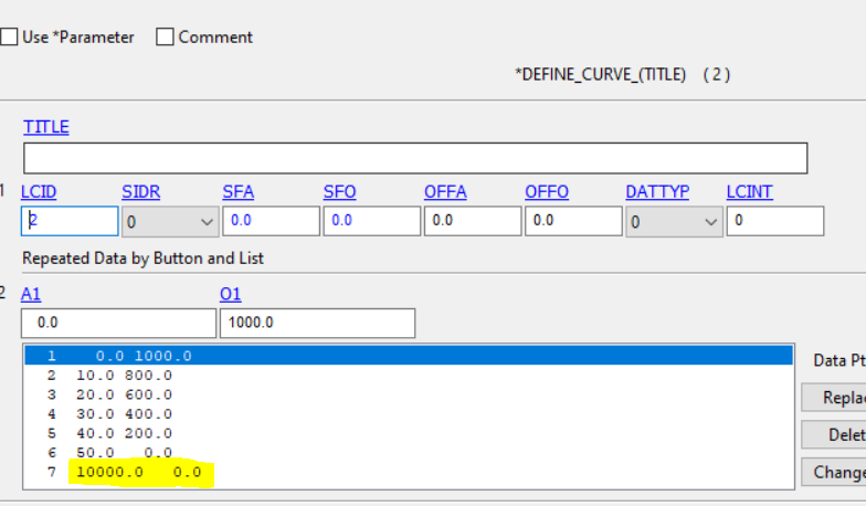

Reno Genest

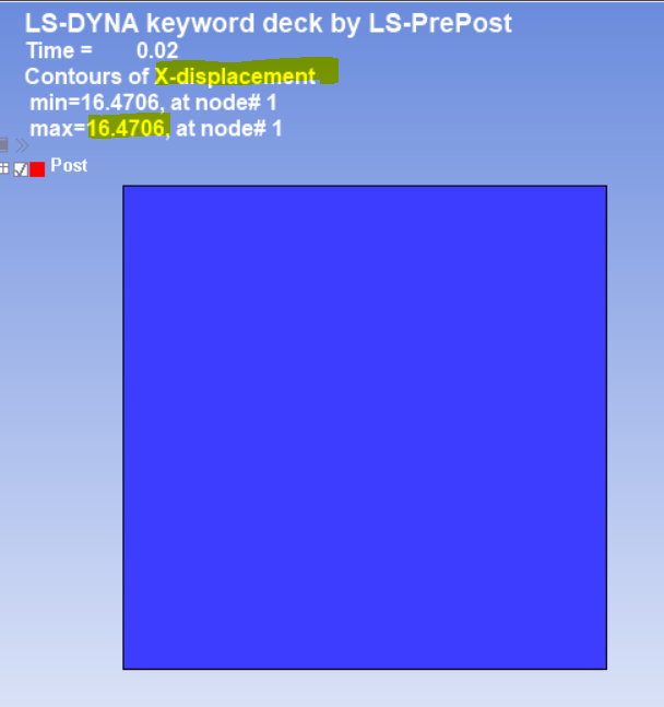

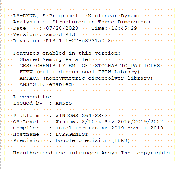

I just created a test model with 1 rigid element and the motion makes sense. The units are ton, mm, s, N, MPa. At time 0, the velocity of the 1 element rigid cube is 1000 mm/s using an *INITIAL_VELOCITY_RIGID. Then, the velocity vs displacement curve is as follows:
Note that it is good practice to extend the curve beyond the point we want to go.
In this case, the relationship between velocity and displacement is linear and as follows:
v = -20*d + 1000
When I look at the results, the velocity at each displacement makes sense. For example when the displacement in X is 16.4706 mm, the velocity in LSPP is 670.586 mm/s which is close to the value calculated with the equation above (670.588 mm/s). I checked many displacement and velocities for the rigid cube and then always match.
I ran on Windows with R12.0.0 MPP double precision with Intel MPI.
I will post the model in the next post. Let me know if it works on your side or not.
Reno.
