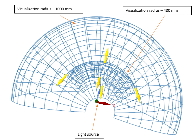

In Ansys SPEOS 2024 R1,
I created two intensity sensors (same origin axis) at differenent distances from the source.
One is located at a distance of 480 mm and the other is located at 1000 mm.
I checked the intensity values after the simulation. Both of them showed the same intensity in candelas (cross checked with various measurement positions).
But, according to the inverse square law, the luminous intensity must fall with greater distances right (intensity ∝ 1/d2) ?
Why i did not see any change in intensity ? suppose if i had done a wrong sensor construction in SPEOS, kindly correct me.

Ansys EmployeeHello,
Please find the explanation for your query belowLuminous Intensity (Candela - cd):
Luminous intensity is the amount of light power emitted by a source in a specific direction, measured in candelas (cd). It represents how bright a source appears when viewed from a particular angle.Mathematically:
I=Φ/Ω
where:
- I = Luminous Intensity (cd)
- Φ = Luminous Flux (lumens, lm)
- Ω = Solid Angle (steradians, sr)
Key Points:
- It describes the directional brightness of a source.
- It does not change with distance (unlike illuminance).
- A point source emitting uniformly in all directions has a total intensity distributed over a 4π steradian solid angle.
Luminous Intensity (cd) vs. Illuminance (lux)
- The inverse square law applies to illuminance (lux), which measures how much light falls on a surface.
- Luminous intensity (cd), however, describes the amount of light emitted in a specific direction. If the light source is directional, the intensity may remain constant across different distances.
the visualisation radius just affects the graphics, but the intensity sensor still have an infinite radius.
If you want to calculate the intensity at a specific distances, you need to switch to TRUE the parameter NEAR FIELD that you have inside the sensor's definition window: https://ansyshelp.ansys.com/account/secured?returnurl=/Views/Secured/corp/v2511/en/Optis_UG_ASP/Optis/UG_ASP/understanding_the_parameters_of_an_intensity_sensor_180916.html

SubscriberHello Alessia,
It's very similar to the case of lightweight & heavyweight geometries!
Thank you very much for clarifying.
