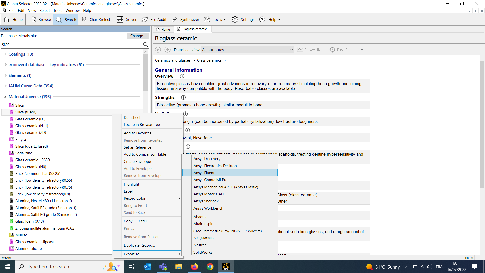

    • David Mercier
      Or if you have access to a Ansys Granta EduPack or Selector license, feel free to use the export function to send properties of a material record into Fluent for example:
