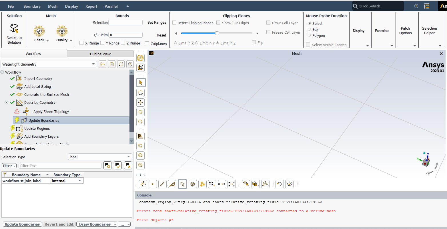

      Every time I import a mesh file to the watertight geometry meshing workflow in Ansys Fluent, the named selections I did before changes and I am not sure why this's happening (for example if I already named a volume, it changes into different namings for the surrounding surfaces of this volume) even When I try to rename it again and change its type to internal in the update boundaries it gives me an error since both a surface and a volume are overlapping and in the update regions panel it doesn't show any regions !

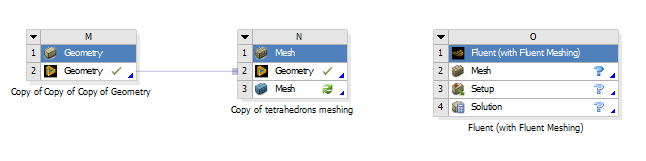

      I am importing a mesh file from the meshing workflow to the watertight gemotery mesh workflow in order to convert the meshing I did before into a polyhedral meshing.

      I have already done a volume mesh through Ansys fluent meshing ( the block connected to the geomtery) then saved the file and imported it again in the watertight geomtery ( the block on the right) so I can transfer the tetrahedrons meshing I did before into polyhedral meshing. I already added the named selections in the old meshing file but after importing it, it was all messed up.

      Please explain step by step. Is Named Selection a problem or poly conversion?
      If you have a volume meshing already generated then use File - Read in Fluent Meshing to read that file. Then check if Named Selections are coming or not.
      For converting tet to poly, you will need to use Fluent solver.
      But instead of poly conversion in Fluent, I will recommend you to generate poly in Fluent Meshing and then proceed.
