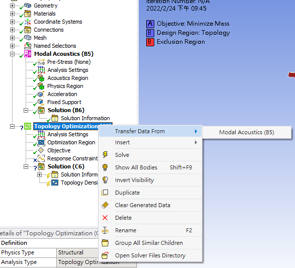

What are you planning to optimize in a modal acoustics analysis?
Regards Ashish Khemka
February 28, 2022 at 12:36 pmtommy123
SubscriberVibration of plates submerged in fluids. Add ribs in the middle of the model ,Topological Optimization for ribs within a specific frequency
February 28, 2022 at 12:56 pmerik.kostson
Modal acoustics is not supported for optimization - see help manual under :
Topology Optimization Analysis (ansys.com)
ANALYSIS TYPES|STRUCTURAL OPTIMIZATION ANALYSIS|OPTIMIZATION ANALYSIS WORKFLOW|
Create Analysis Systems (ansys.com)
All the best
Erik
