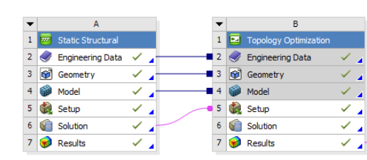

Subscriber-Hi, I am going to perform a topological optimization based on density and I need help on how to incorporate a safety factor condition.

December 16, 2021 at 5:57 amBalc
Hello, thank you for replying.
I think I have not explained myself well, I need to know how I can add a responsive constraint in relation to a safety factor. For example, I need a topological optimization with two responsive constraints:
1: a mass reduction of 80%.
2: a safety factor of 2.
Is it possible to implicitly designate a factor of safety by setting a responsed constraint of the global von mises stress?
the static structural toolbox is already linked to the topological optimization toolbox
thanks
December 16, 2021 at 11:04 pmpeteroznewman
SubscriberYou can apply a Stress Constraint and just use a value of Von Mises Equivalent Stress that is half of yield strength. That will mean a Factor of Safety of 2 on Yield.
