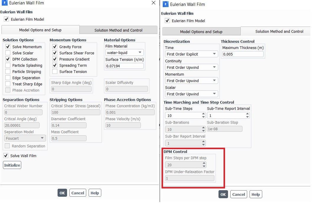

I am trying to activate 'DPM control ' panel. According to ANSYS presentation if I turn on 'DPM collections' in the 'Model Option & Setup' tab , I should be able to activate 'DPM Control' panel. I did this ,but still my DPM Control panel is inactive. I need to set the Film step per DPM step and DPM URF. How can I do this?
Moreover, I turn on DPM model and set two injections there.

Forum ModeratorHave you set the DPM panel to "interacts with continuous phase"? You may also need transient particles.
July 15, 2021 at 12:12 pmDrAmine
Ansys EmployeeIf not coupled to flow you will be able to see it.
July 15, 2021 at 4:49 pmAnadi_Mondal
Subscriberand I got my answer. I checked that if' interacts with continuous phase' is not enabled, DPM panel is active in EWF.
