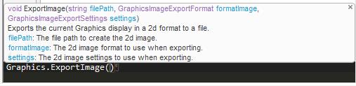

      senior2020design, Is there any specific reason to use "Graphics.ModelViewManager.CaptureModelView" ? Can you use "Graphics.ExportImage" instead?
      -Aniket
    • senior2020design
      The issue I am running into with using API Methods that takes in a string filepath such as "Graphics.ExportImage(filePath)" is that the user can save their created Project anywhere on the hard drive. So I do not want to specify a specific filepath to save images because that would confuse users that have saved their Project into a different directory in their hard drive. The "Graphics.ModelViewManager.CaptureModelView" some how finds where the Project was saved and saves the image files into the user_files directory in the Project folder.
      I have Version 2019 R1 and I could not seem to identify the existence of the GetUserFilesDirectory() in the reference guide.
      Thank you for all the help, please let me know what other options are possible.
    • Aniket Chavan
      but you can always get the filepath string using GetUserFilesDirectory() from the workbench page right? Did you check the link that I gave?
      GetUserFilesDirectory() is a workbench level command so you will be able to execute it from ACT console on Workbench page (not from ACT console in Mechanical).
      The link I gave shows how to run workbench level commands from Mechanical. And "filepath" is literally a string, there should not be any issue to manipulate it and force it to the output of command GetUserFilesDirectory() using basic python commands.
