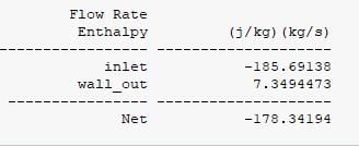

      To estimate the total heat transfer rate at the inlet and outlet, please go to 'Surface Integrals', choose 'Flow Rate' for the 'Report Type', select 'Enthalpy' (in the Temperature category), and select your inlet and outlet surfaces over which you would like to integrate.
      The total Q reported by Fluent crossing the inlet and outlet is the surface integral of
      [enthalpy x density x velocity vector x dA]

      After using the method you described with Surface Integrals and Flow Rate for inlet and outlet, the values are the same as calculated by hand and everything is as predicted.

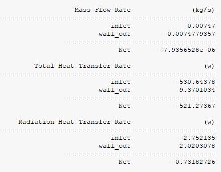

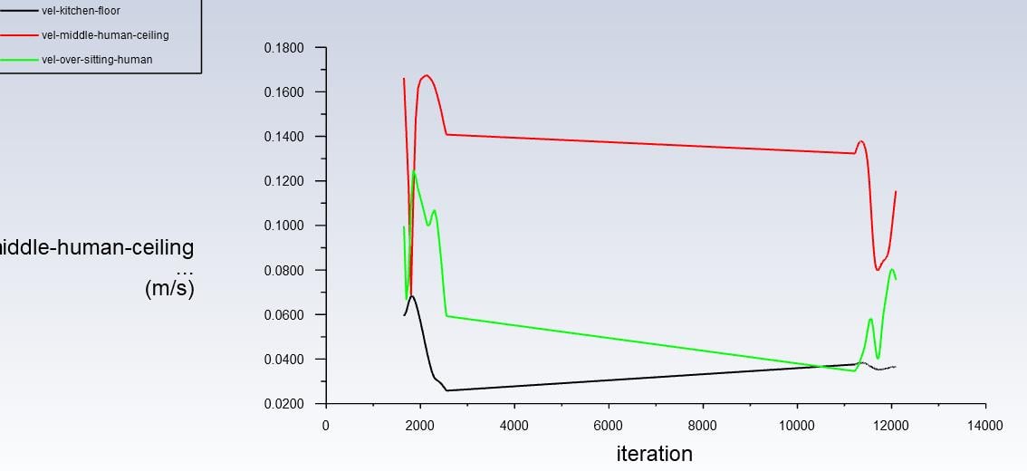

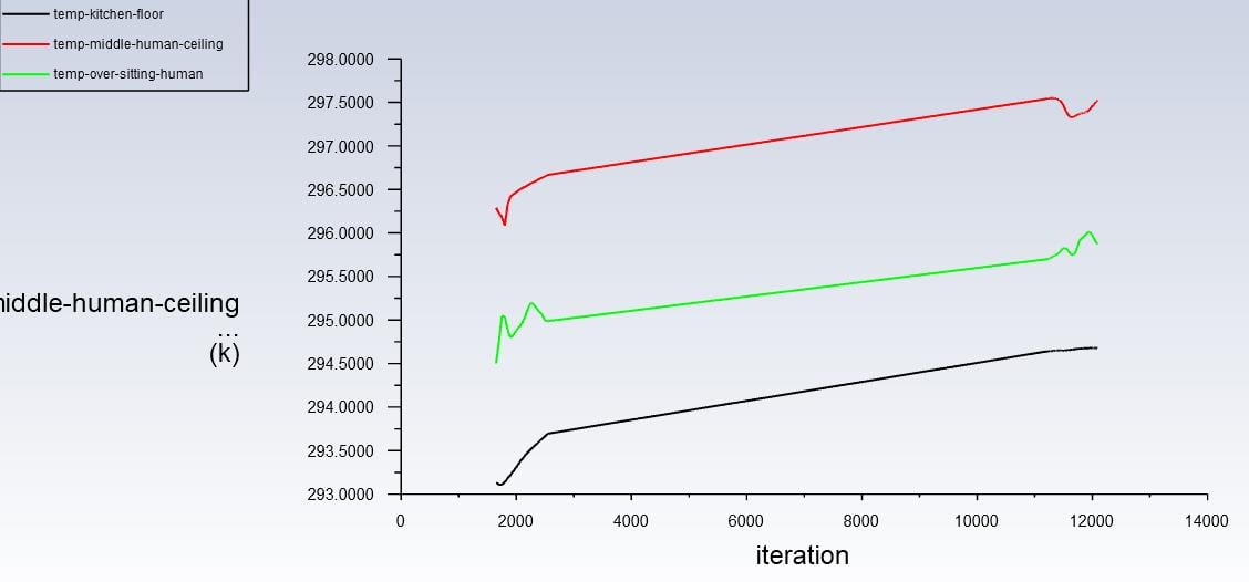

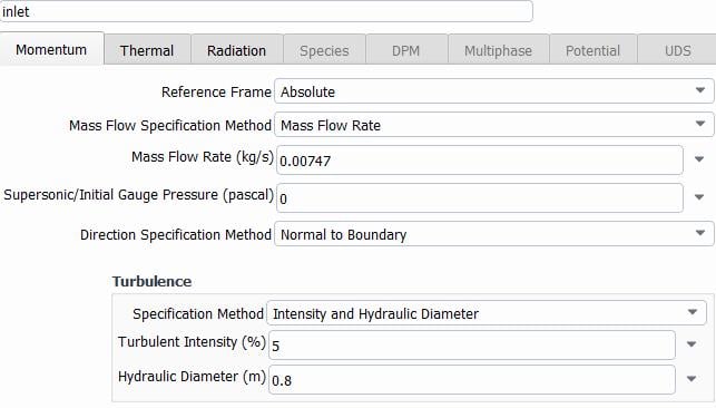

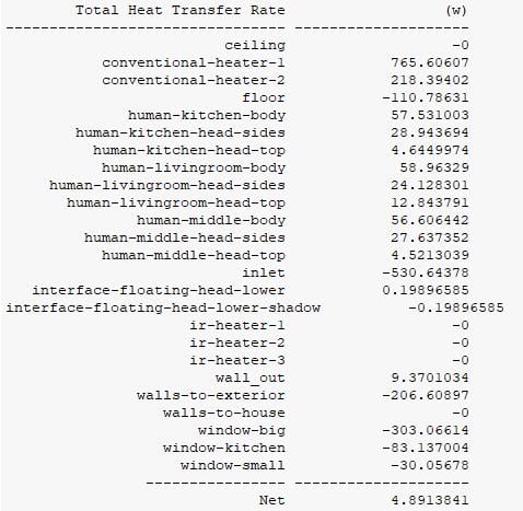

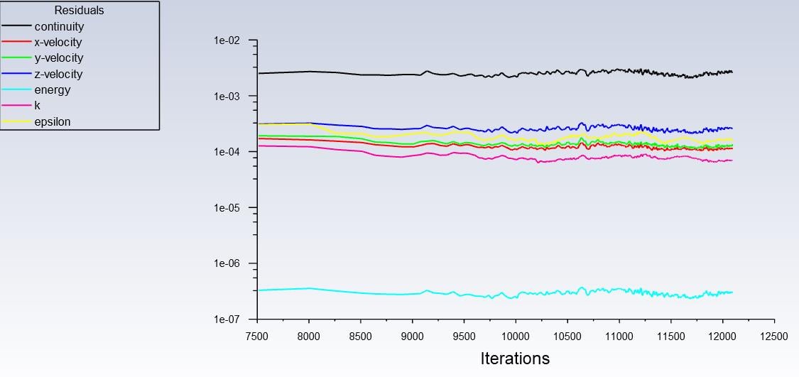

      here are the screen shots of flux reports, enthalpy flow rate, convergence (residuals + some of the points in the room monitored), inlet and outlet settings. The convergence now does not look perfect, because around 1k iterations before I changed inlet and outlet from velocity type to mass flow type (before outlet was a negative velocity inlet). Nevertheless, before these changes, when all the results were already quite stable, all of the heat fluxes were almost the same (inlet heat flux was around 5W less).
      On the screen shot with all BCs' heat fluxes you can see some external and internal walls of the room, surfaces of humans' models and some heaters (in this simulation only conventional heaters are turned on). All of these fluxes as reasonable according to hand calculations, except inlet and outlet.

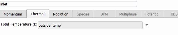

      Outside_temp (for inlet thermal condition) is 273.15K. Average temperature for the whole domain is around 295.6K and for outlet is around 297.2K.

      When you have radiation included in your model, the total heat transfer flux reports both convective and radiative heat transfer. It is the sum of both. However, the flow rate of enthalpy will only predict the convective portions. If you were not solving the radiation model, these two values would match.
      Thanks.

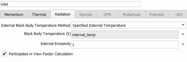

      as you can see I included also radiation heat fluxes for inlet and outlet. For inlet it is around -2.8W, which means that inlet convective heat flux should be around: -530.6 - (-2.8) = 527.8W.
      If I am not right, what is the Radiation Heat Transfer Rate then?
      Black Body Temperature for inlet = internal_temp, which is set to 294.15K (the radiation heat flux from the inlet should be close to negligible then).

      Please converge your solution more deeply. Fluxes do not get computed properly if you do not have proper convergence. I'd first make sure you are converging deeply and your net heat flux reported by Fluent is less than 1% of the smallest flux you are seeing in those reports. Once you are able to achieve this, please try these hand calculations and see if these match up with your Fluent calculations.
      Otherwise, please try and use an existing and converged solution and check your hand calculations to understand what Fluent is doing.
