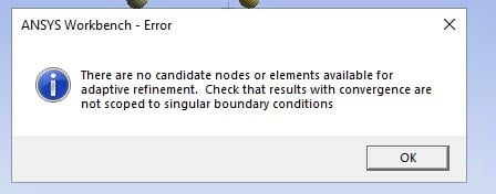

Subscriberhi peteroznewman,
thanks for your quick response, i am worried whether or not i should reduce my allowable change to below 3% and run the simulation again with few more refinements.Â
my meshes looks very well, have obtained the force convergence robustly however Is it safe to consider this stress value obtained currently?? even if i reduce the allowable change to 3% for next adaptive mesh refinement i get the following error as attached in image.

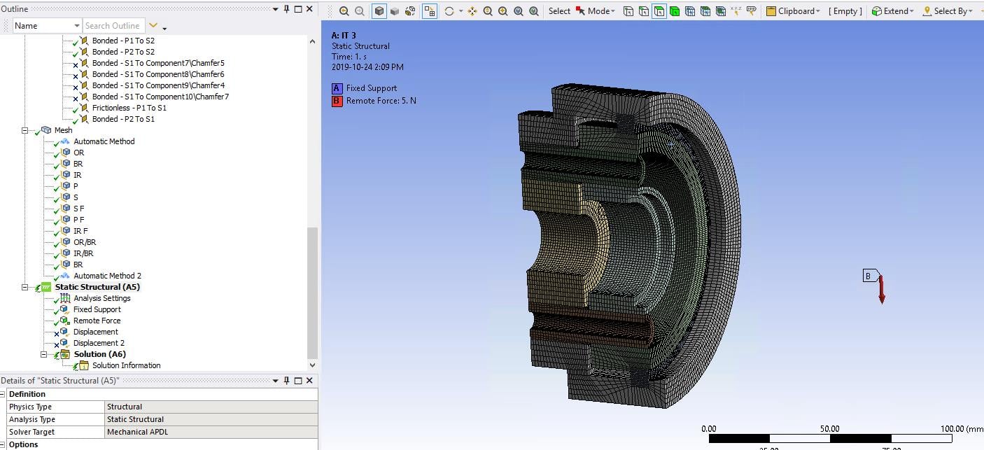

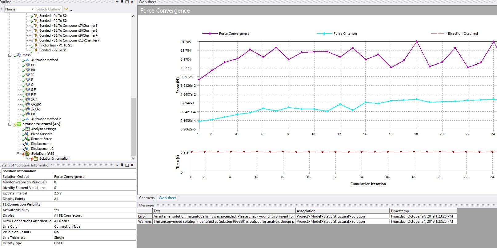

Subscriberthanks peteroznewman,
the shared post was very useful to me. I have another simulation running i am not able to decide which boundary condition i should use to restrict rigid body motion. I am trying to run a bending moment analysis on planetary gear train assembly as shown in the image. I just want to see the maximum stress generated on on planets. Planets are free to rotate and revolve in between two suns and outer ring. How can i restrict the rigid body motion. I am unable to obtain the force convergence.Â

peteroznewman
SubscriberA half model doesn't make sense for a planetary gear model.

Jerin
Subscriberactually i have provided symmetry loading conditions on half side, i forgot to add it in last workbench file but i have inserted the symmetry region and its still giving me rigid body motion, the aim is to see where maximum deformation occurs under bending moment. The planets are free rotate and revolve , and one of the sun is free to just rotate in its own place. I have added frictionless support in between planets and sun because of which there is a rigid body motion.

peteroznewman
SubscriberA half model doesn't make sense for a planetary gear model even when you include a symmetry BC.

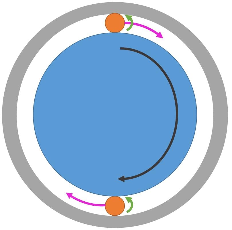

peteroznewman
SubscriberYes, the geometry is symmetric, but the motion of the parts is not.
In the image below, the outer grey ring is fixed, the inner blue sun gear rotates in the direction of the black arrow, the orange planet gears rotate in the direction of the green arrows while also traveling in the direction of the magenta arrows.
Yes, the geometry is symmetric, but the motion of the bodies is not symmetric, and motion is what is important for using symmetry boundary conditions.
If you slice this geometry vertically, and apply symmetry, then the sun and planet gears are no longer free to rotate or move along the magenta arrows.
