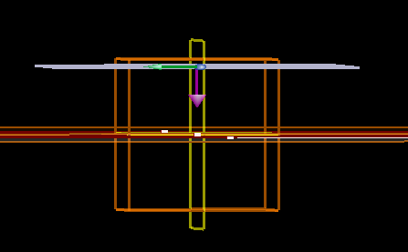

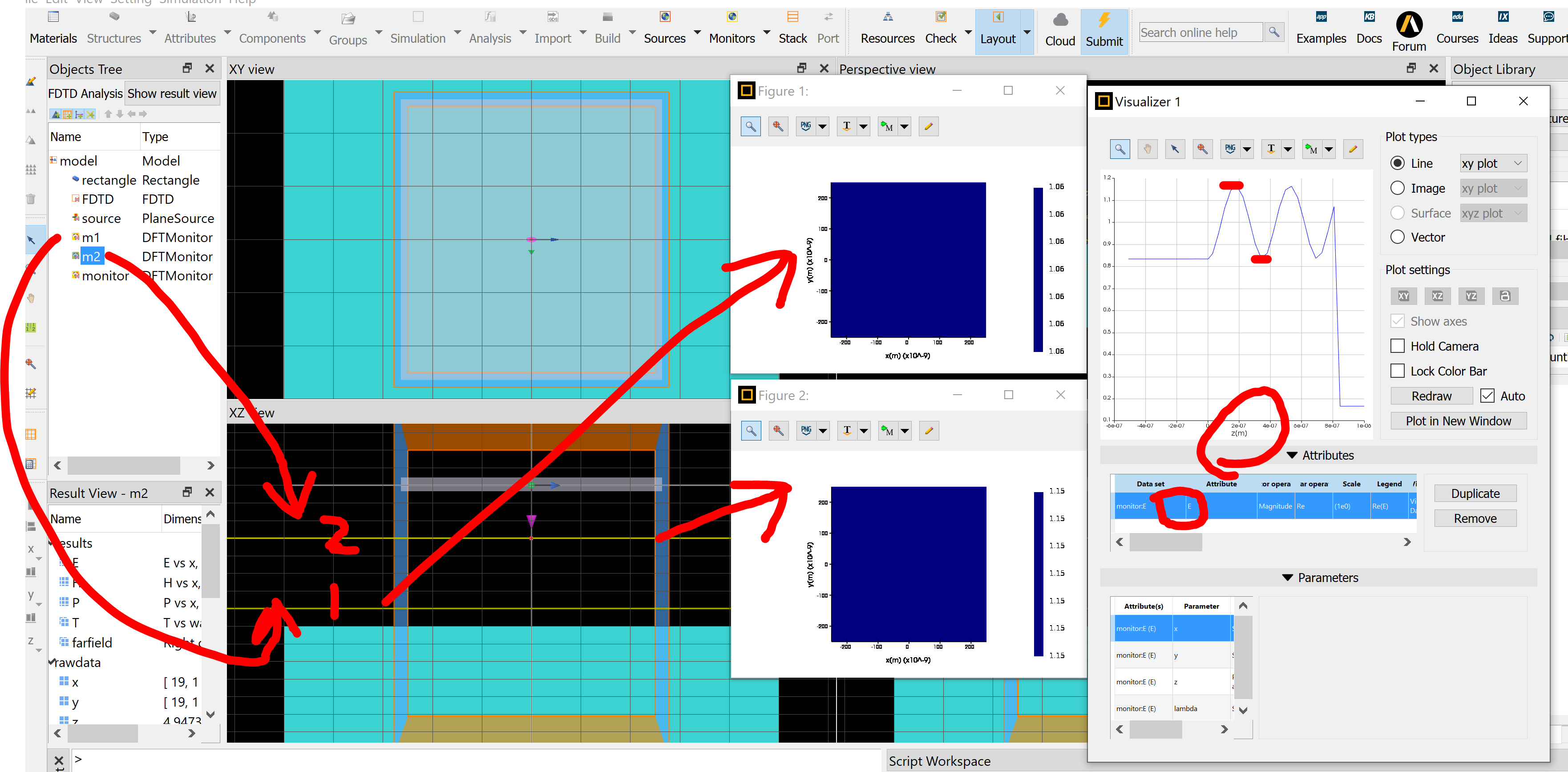

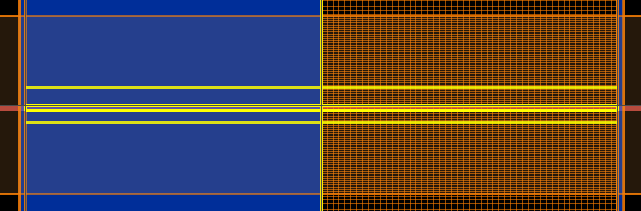

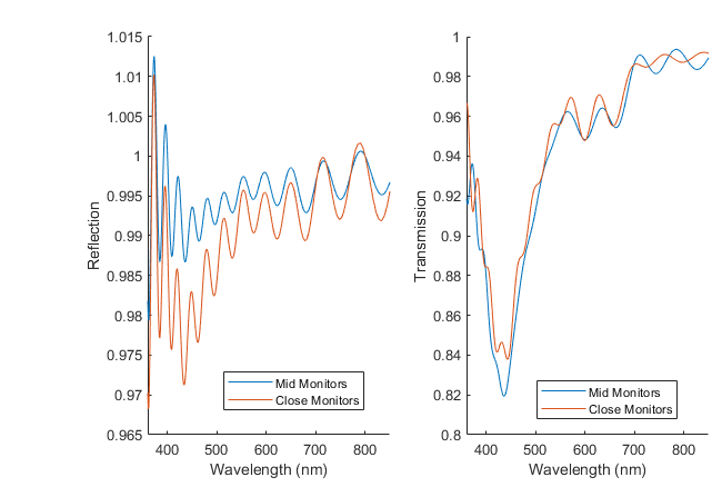

March 23, 2022 at 8:42 pmserenek4
SubscriberThe attached screenshots are below, which shows that I had a very thin flat material inside the cavity, with "close" monitors right next to the material and "mid" monitors farther from the material on both sides. I observed reflection from the black surface as you mentioned. Could you please explain what causes reflection / interference from the back surface? Also, in general, how would you recommend determining reflection AND transmission through a material? Specifically for reflection, would putting a monitor behind the source determine the material's reflection without interference from the incident wave?
Also, I don't really understand what you mean by "Only when the monitors are located in uniform material without any material interface behind it, including air or background material, then the result should not change much in different locations." Isn't there always a material interface in the simulation as long as you have materials / structures? Could you provide an example of what you meant by this?

March 24, 2022 at 8:31 pmGuilin Sun
Ansys Employee"Isn't there always a material interface in the simulation as long as you have materials / structures? Could you provide an example of what you meant by this?"
not true. When the substrate is truncated by PML, except the top air/material interface, there is no other interface.
Since it is a cavity, and you plot transmission and reflection, it is normal to have different peaks and valleys. PLease place a monitor behind the source and add R+T to check if it is smaller than or equal to 1 within simulation errors.
When the monitor is in between the source and the front surface, you will need to add or substract 1 from the monitor transmission. Please refer this Tips for accurately measuring reflection in an FDTD simulation
March 24, 2022 at 8:54 pmGuilin Sun
For your simulation, there is another possibility: the simulation may need much smaller autoshutoff min than 1e-5. So please decrease it to 1e-8, increase simulation time, and check the monitor
