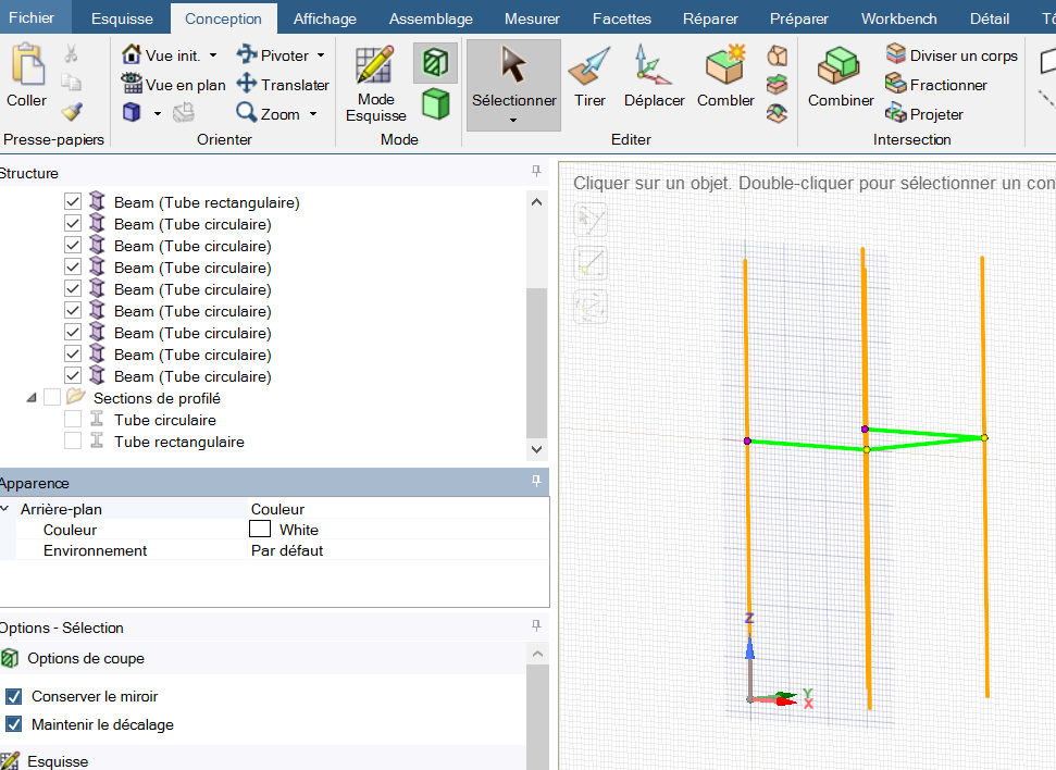

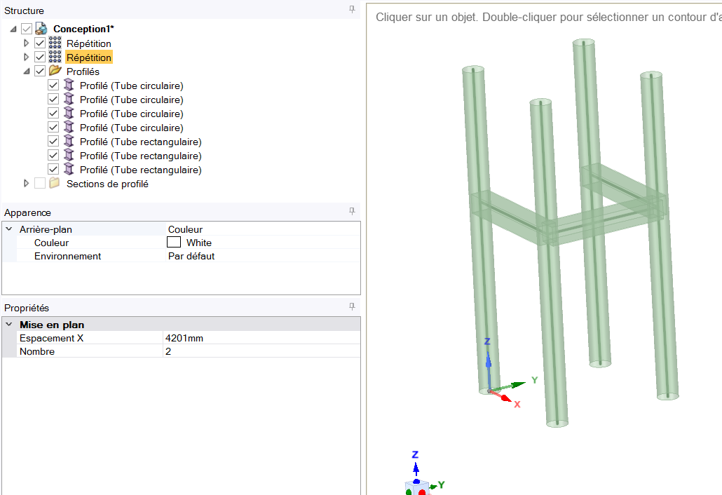

I wanted to draw a tank support on spaceclaim, with 2 profiles a circular tube and a square tube, I drew the support but it still in 1D how I can do to work in 3D in spaceclaim.
May 10, 2021 at 3:20 pmpeteroznewman
SubscriberBeam elements are a great way to quickly evaluate the tank support structure.
If you want more detail about the stress in the welded joints between the circular tube and the rectangular tube, then you need to go to the Design tab and extrude surfaces to represent the square profile and other surfaces to extrude a circle into a cylindrical tube. You will need to use Split Body to construct the intersection between the two tubes. Use the Prepare tab and click the Share button to create the weld line. When you bring those surfaces into Mechanical, you can mesh them, support the bottom edges and connect the top edges to the tank.

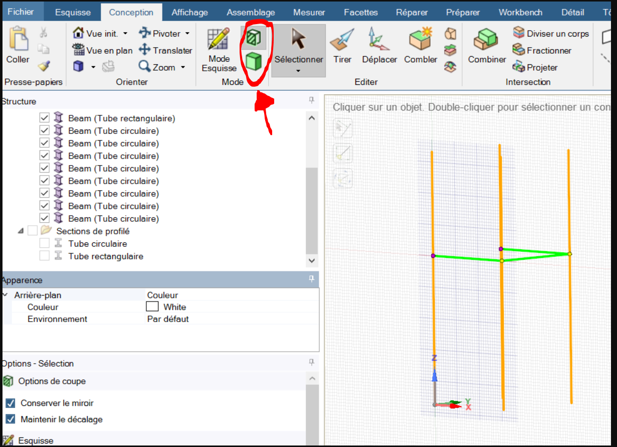

May 11, 2021 at 11:45 amoumaimalahmar.ol
I know how to do it but it's not the same for my case, here I draw lines after I import the profiles I wanted, and from these profiles I can't make a surface extraction.
In the normal case we do PULL but in my case it already draws the profiles and my structure remains in 1D.

Finally, have in mind you can not extrude a beam cross section (what you call profiles-'profiles I wanted, and from these profiles I can't make a surface extraction': you can not extrude these, these are only for assigning sections to beam element), you need to have a sketch as in the video, so you need to define those yourself manually in SC from scratch, and then which you can then finally extrude like in the video.

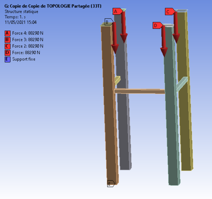

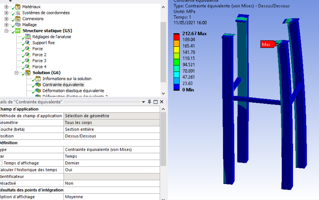

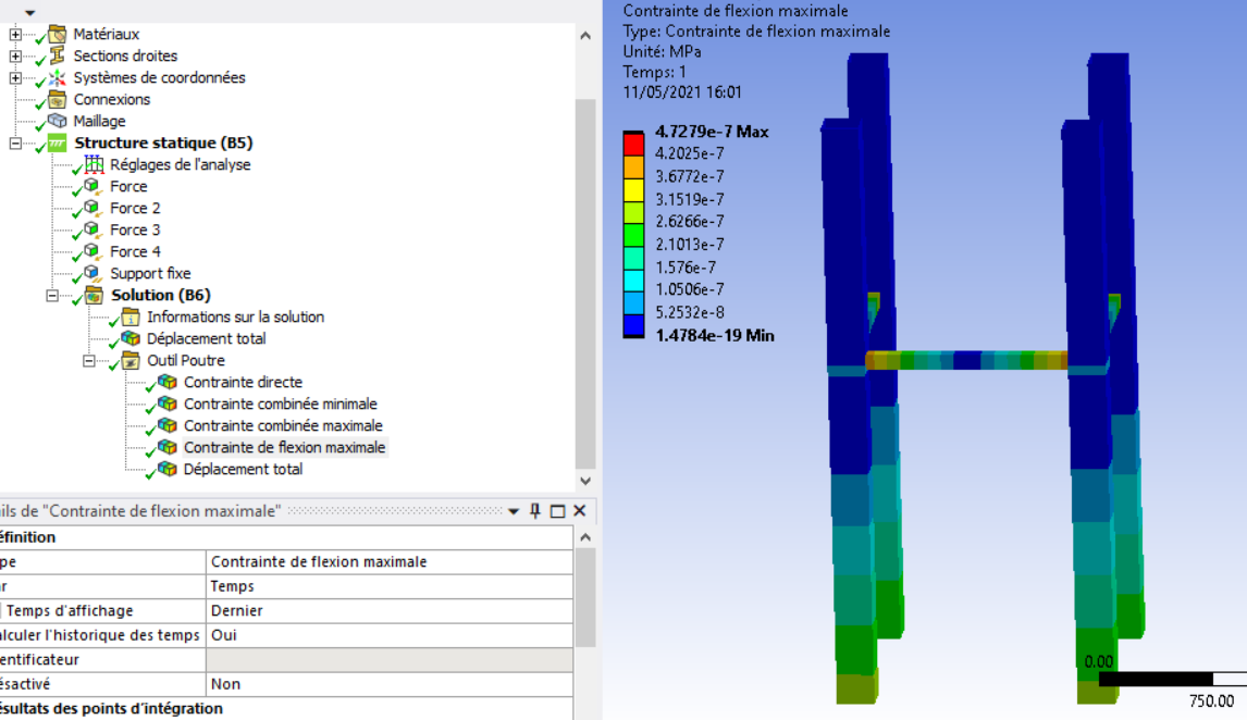

May 11, 2021 at 2:04 pmoumaimalahmar.ol
SubscriberThank you Indeed, with the 3d model I find a max stress of 212 MPa and in the corners on the other hand in 1D I find a stress of 4.07 e-7 MPa?
I have no idea where this difference in stress level comes from and why we have a foreign stress in the 3D module?
even the location of the constraints is different
