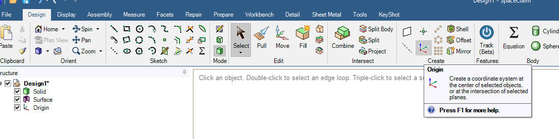

      you can orient your model instead.
      work on the model and then reorient model.
      also you have option for creating coordinate system as

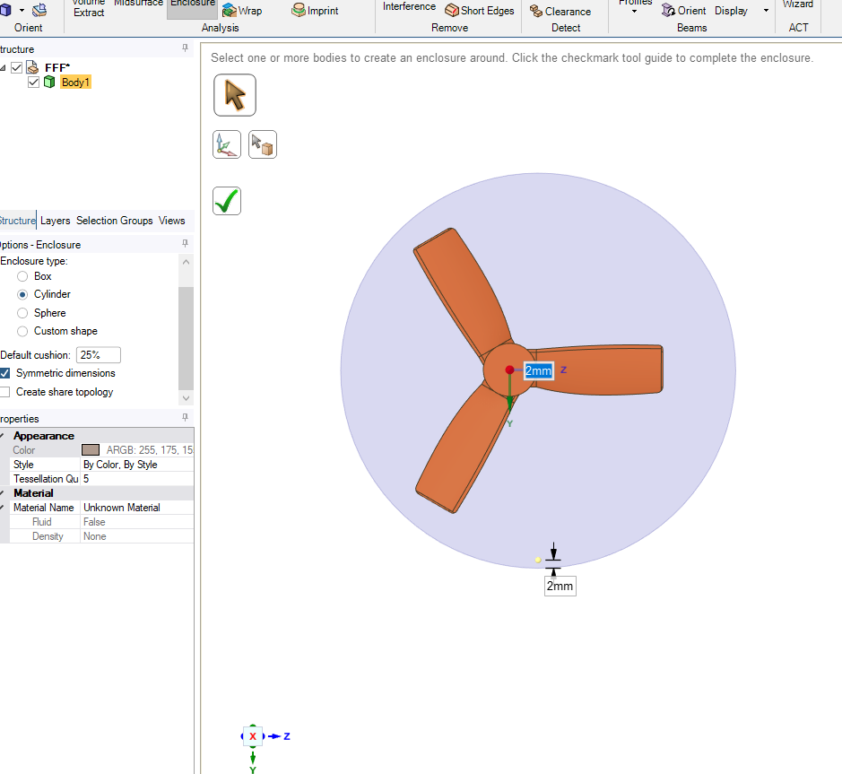

      I want to create cylinderical enclosure for propeller but enclosure does not looks like concentric with propeller because spaceclaim is taking different origin that away from center of propeller.
      How can I define propeller center to the enclosure property ?
